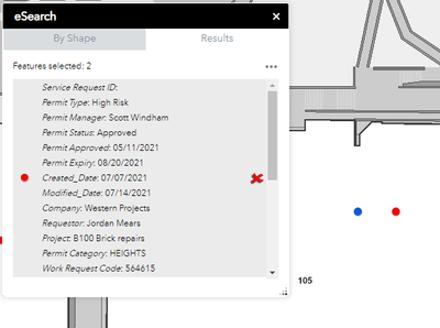

Hi @RobertScheitlin__GISP , thanks for the response. It does sound like the issue with the url path. To demonstrate, this was my search symbology settings:
And this was the display after selecting these two points:

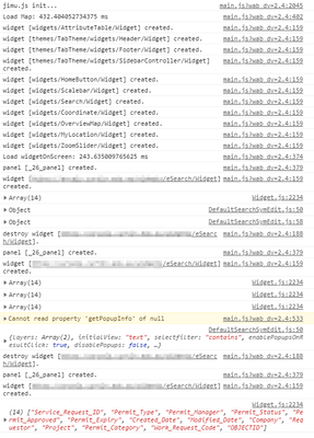

I don't think there are errors, this was the developers console:
MVP Emeritus
@PropertiesCurtin  version 2.4 is very old and many enhancements have been made since then (think about it that is 16 minor version behind). I pretty sure that you have the layer set to use symbology "from Server". If you change it to "from Defaults" then you will see the light cyan circle you have showing in your image.
PropertiesCurtin
@RobertScheitlin__GISP  yeah, we're pretty behind with ESRI versions, hopefully that'll be upgraded in the not too distant future.
I changed it to 'from Defaults' and it's all fixed, thanks again Robert.

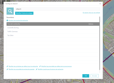

KARIMLABIDI

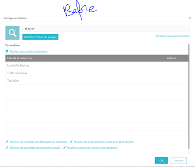

Hello Robert, I am new on WAB , i would like to use your Widget but it doesn't work !I can't choose any layer.
I try your other widget ,Identify, to try and see if the problem is my PC but it works lika a charm.
So , i don't understand why this widget doesn't want.
If you can help me, it will be very grateful!
Thanks
MVP Emeritus
@KARIMLABIDI
So what happen when you click the "Ajouter une couche de recherche" link?
KARIMLABIDI
it adds empty lines and that's all
MVP Emeritus
@KARIMLABIDI
But when you click that link it does not bring up a new dialog titled "Update Search Layer" (of course that title in in English for me)?
KARIMLABIDI
No, nothing happens, nothing appears. I don't know why.
MVP Emeritus

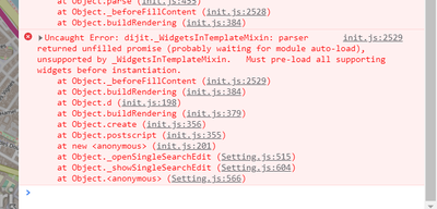

There must be an issue in the French localization of the dialog. So the quick fix is to make the widget show in English for you. To do this go to the strings.js file for the app you are working in (i.e. server/apps/[App#]/widgets/eSearch/nls/strings.js) and open it in a text editor and set the
"fr": 1,
to
"fr": 0,
Save that file and restart WAB.
Ultimately it will help to find the localization string that is causing the issue by opening you browsers web console and seeing the error(s) displayed there.

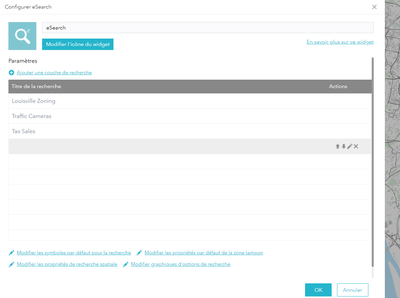

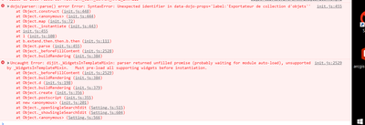

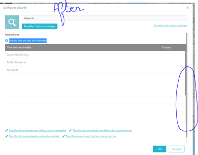

KARIMLABIDI
i have this
MVP Emeritus
@KARIMLABIDI
OK. In that case then you need to disable the French locale in the settings dialogs too.
server\apps\2\widgets\eSearch\setting\nls\strings.js
Change "fr": 1, to 0
KARIMLABIDI
that's the same link no?
KARIMLABIDI
ah sorry, i didn't see the "setting"
KARIMLABIDI
I got this
MVP Emeritus
@KARIMLABIDI
What version of the widget code did you download? I have fixed those French locale issue in the strings.js a couple of releases ago. The error you are showing is that the single quote in the settings.js strings has to be escaped. For example in your version it has:
allowfcexport: "Exportateur de collection d'objets",
and in more recent version it is:
allowfcexport: "Exportateur de collection d\'objets",
Notice the \ (backslash) before the '(single quote).
All single quotes in the
server\apps\[App#]\widgets\eSearch\setting\nls\fr\strings.js
have to be escaped with a backslash.
KARIMLABIDI
i think I have download the last version, the 2.17, i have download with the link eSearch.zip . Maybe , i made a mistake. How I know the version?
KARIMLABIDI
The manifest
MVP Emeritus
In WAB you can Hold the Alt key on your keyboard and then click on the Widget (not the settings dialog, but the actual widget) and a new popup will appear that tells the widgets version number.
