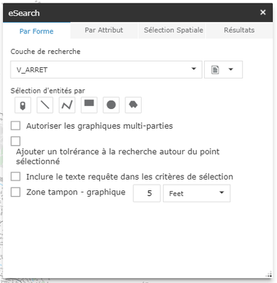

KARIMLABIDI
@RobertScheitlin__GISP
ok it works but now it's in english 😉
i have to change the Json but which one?
thanks
MVP Emeritus
OK, So as I mentioned before change this file.
[install directory]\server\apps\[App#]\widgets\eSearch\setting\nls\fr\strings.js.

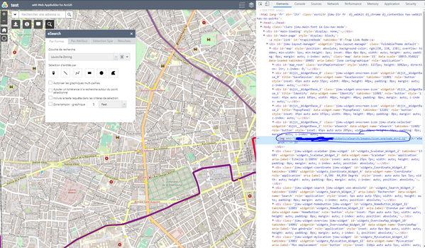

KARIMLABIDI
Hello @RobertScheitlin__GISP  I have clean everything and the widget works in english but not in french.
MVP Emeritus
@KARIMLABIDI
So did you re-enable the French locale?
server\apps\[App#]\widgets\eSearch\setting\nls\strings.js
Change "fr": 0, to 1
KARIMLABIDI
yes but ultimately it does not matter. The configuration is in english but the tool is in French for the user, it is the main one.
Thank you for your help and it's a great widget!

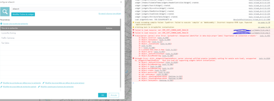

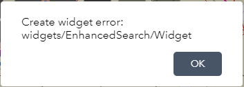

mohannainar1
I am getting the below error while opening the widget
I created application from web app builder developer edition
WAB version 2.21 and ArcGIS Enterprise 10.8.1
MVP Emeritus
@mohannainar1
What version of version of the widget are you using? What are the error(s) in the browsers web console?
mohannainar1
"version": "2.21.1"
Console error :
MVP Emeritus
@mohannainar1
Can you share the theme portion of your apps main config.json file? For example:
  "theme": {
    "name": "FoldableTheme",
    "styles": [
      "yellow",
      "default",
      "black",
      "blue",
      "cyan",
      "green",
      "purple",
      "red"
    "version": "2.21",
    "sharedTheme": {
      "isPortalSupport": true,
      "useHeader": false,
      "useLogo": false
    "customStyles": {
      "mainBackgroundColor": "#5a6b4d"
mohannainar1
find the details below.
"theme": {
"styles": [
"yellow",
"default",
"black",
"blue",
"cyan",
"green",
"purple",
"red"
"version": "2.21",
"sharedTheme": {
"useHeader": true,
"useLogo": false
"customStyles": {
"mainBackgroundColor": "no-color"
MVP Emeritus
@mohannainar1
OK I have never seen the "mainBackgroundColor" set to "no-color" before now so the code is not handling that correctly. You can make this change in the widget.js file of the eSearch widget or wait for a new fixed version to be released.
      _addCustomStyle: function(theme) {
        var customStyles = lang.getObject('customStyles', false, theme);
        if(!customStyles || !customStyles.mainBackgroundColor ||
          customStyles.mainBackgroundColor === "" || customStyles.mainBackgroundColor === "no-color"){
          return;
mohannainar1
@RobertScheitlin__GISP  I Changed the background color to valid value, now the widget is working. Thanks a lot for the quick solution.

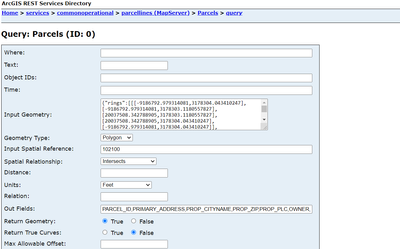

PriscillaThoopthong
I'm using the latest version of the widget.  When I zoom in, and then use the search by shape with a point it selects over 2000 records, no the one record it should.  This only happens when I'm zoomed into my map very closely.
It runs for a very long time and then comes back with this:
using debugging tools my query object looks like this:
but the actual query it send through (according to the network tab in the debug tools) looks like this:
It creates rings instead of points:
{"rings":[[[-9186792.979314081,3178304.043410247],[-9186792.979314081,3178303.1180557827],[20037508.342788905,3178303.1180557827],[20037508.342788905,3178304.043410247],[-9186792.979314081,3178304.043410247]],[[-20037508.342788905,3178304.043410247],[-20037508.342788905,3178303.1180557827],[-9186793.904668545,3178303.1180557827],[-9186793.904668545,3178304.043410247],[-20037508.342788905,3178304.043410247]]],"spatialReference":{"wkid":102100}}
MVP Emeritus
@PriscillaThoopthong
An extent is applied to the point graphical search based on how the widget is configured. If you do not want the point to have a search tolerance added to it then uncheck the "Add search tolerance to point selection" on the widget.
PriscillaThoopthong
Thank you Robert.  I had just figured that out myself.  But let me ask you, if my search tolerance is set to 6 why would it select the parcels that it's selecting?
MVP Emeritus
No it should not. Seems like I remember on other person have an issue like this and the issue had to do with some bad geometry in their service they were searching. Sorry that was a long time ago so I don't recall much of the details.
PriscillaThoopthong
It doesn't seem to matter which parcel I click on.  It always seems to do the x coordinate like that and not the y.  Strange

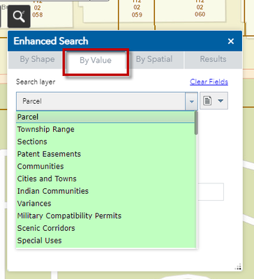

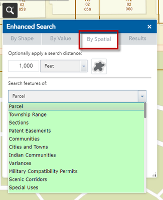

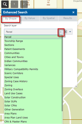

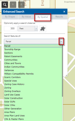

DavidDas__GISP
Hi Robert,

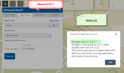

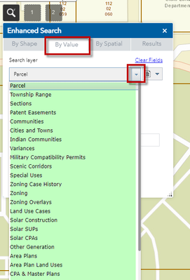

I tested eSearch version 2.21.1 on Web AppBuilder version 2.22.
The Max Row limit to 10 rows is not working.
Here is the Search Layer drop down under the By Value Tab
Here is the Search Features of drop down under the By Spatial Tab
Here is the Search Layer drop down under the By Shape Tab
If you could tell me exactly what changes to make to the code, I could modify it myself till you release a new version.
Best regards,
David Das
MVP Emeritus
@KindraBlair
I am not a ArcGIS Enterprise user, but. You just need to follow the steps you would normally use for adding a custom widget and replace the eSearch widget with the new version. As far as apps you have that have eSearch configured they will remain configured as their configuration file is separate from the eSearch widget folder.
MVP Emeritus
@DavidDas__GISP
The change is simple. In the Widget.html file make these changes (adding data-dojo-props="maxHeight:200"):
        <select class="esearch-select-graphic" style="margin-bottom:10px;float:left;" data-dojo-attach-point="selectLayerGraphical"
          data-dojo-type="dijit/form/Select" data-dojo-props="maxHeight:200"></select>
        <select class="esearch-select-attrib" style="margin-bottom:10px;float:left;" data-dojo-attach-point="selectLayerAttribute"
        <select class="select-layer-spatial" data-dojo-attach-point="selectLayerSpatial" data-dojo-type="dijit/form/Select" data-dojo-props="maxHeight:200"></select>

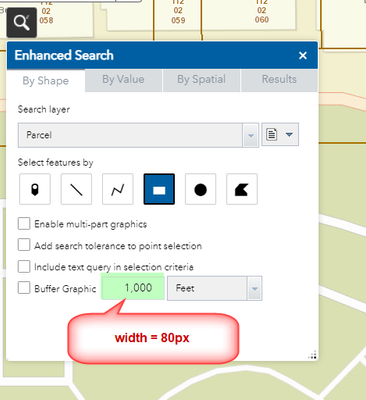

DavidDas__GISP
Hi Robert,
Success!!
Thanks so much for your expert tips.
I learned something new today.
I set the maxHeight property to 235 to get it exactly the way I wanted.
data-dojo-props="maxHeight:235"
By Shape Tab
By Value Tab
By Spatial Tab
I had no clue that you could set these Dojo Properties in the Widget.html file.
I expanded the width of the Text Box for entering the Buffer Value under the By Shape Tab from 50px to 80px.
I can now enter a buffer distance of 1,000 feet without the value being cut off.
I can hardly wait to see this Widget ported to the Experience Builder.
It would become the centerpiece of all Experience Builder apps.
The simplicity of the User Interface in the Enhanced Search Widget belies the complex graphical and spatial searches one can perform with just a few mouse clicks.
Best regards,
David Das

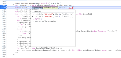

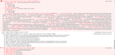

Hello,
I don't see related data.
I have a map service with a layer and a table of related records. When I configure the widget for related records it sees that a relationship exists and it allows me to add the fields from the related table but don't show in Search by value tab.
Console error :
zrs
New Explorer
In addition to @KristinaMarkocevic's comment I have the same problem. This error shows up if the attribute table is not open prior to launching the eSearch widget.
But if the attribut table is open the next issue is caused by code few lines beneath in the _createLayerAndExecuteQuery method. Namely, the relateId argument that is supplied to the method is the id of the related object but the method tries to query the relates array as if it was tthe array index and breaks.
I tried the eSearch widget version 2.21.1 with few Web AppBuilder and ArcGIS Enterprise versions:
ArcGIS Enterprise 10.8.1 - Web AppBuilder 2.19 - 2.21 - 2.23
ArcGIS Enterprise 10.9.1 - Web AppBuilder 2.21 - 2.23
Any help would be appreciated.

@KristinaMarkocevic
From the widgets documentation:
  • The Show Relates command opens and sends the search relates to the Attribute Table widget.
https://gis.calhouncounty.org/WAB/V2.21/widgets/eSearch/widgets/eSearch/help/eSearch_Help.htm
The error you have posted above is pointing to there being an issue with not being able to find the ObjectID field in the search results.
