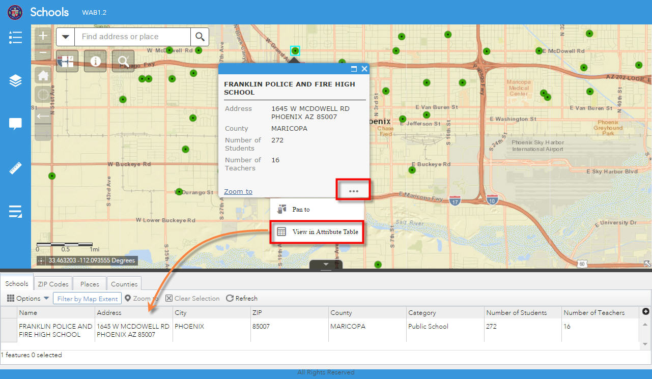

Moxie's team has added a new Options Button on the ESRI Popups.
The user can click the Pan to option to move the graphic to the center of the map.
The user also has an option to open the Attribute Table and view the Attributes.
This is the quickest and most elegant way to display the attributes of a feature the user has selected.

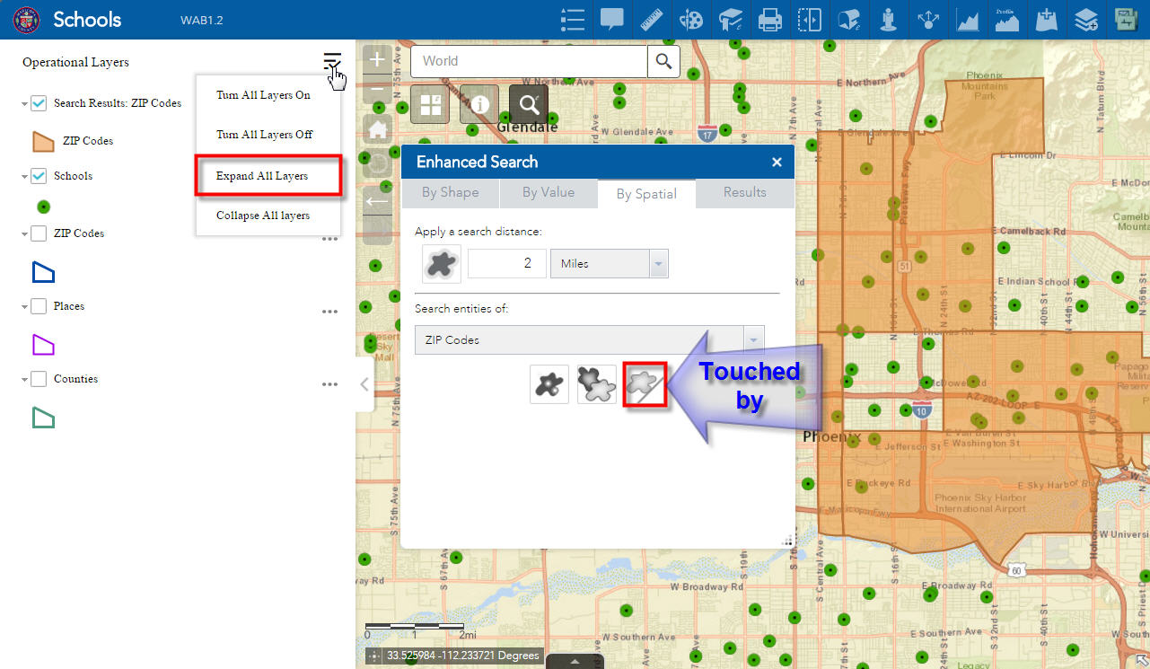

I see that you have taken the Options Button to a whole new level in your Enhanced Search Widget version 2.1!!
I like how a white border appears on the active tool.

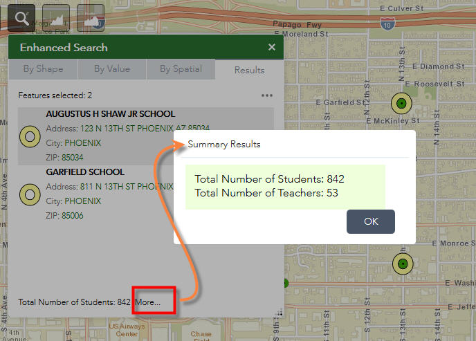

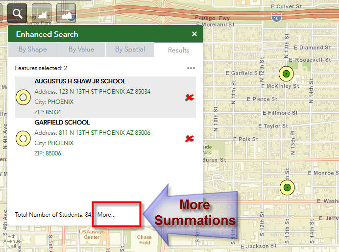

The More... button stills gives me additional summations

You have retained the View in Attribute Table option that now comes with every ESRI Popup.

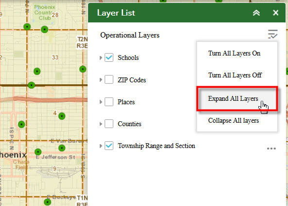

I like the option menu on the Layer List widget
This makes it very easy to expand all the layers and view the legend.
