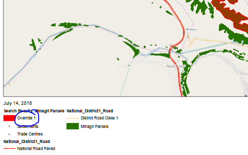

AnninaHirschi_Wyss1
Hi Robert,
I just discovered two typos in \setting\nls\strings.js:
  • editResultFormat: "Edit Result Formating", > Formatting
  • fromatTooltip: "The formtting set here will affect the result popups and widget result text",  > formatting (and maybe you want to correct also the formatTooltip
Then I have another question:
Is there a way to rename the "Override 1" next to the search result in the Legend when printing? I would like to call it "Search result" or let it empty:
Thanks a lot,
Annina
RobertScheitlin__GISP
MVP Emeritus
Annina,
  Thanks for the info on the spelling corrections. Unfortunately I have dealt with esri on this legend issue already and it is a ArcGIS Server print task issue I have no control over.
