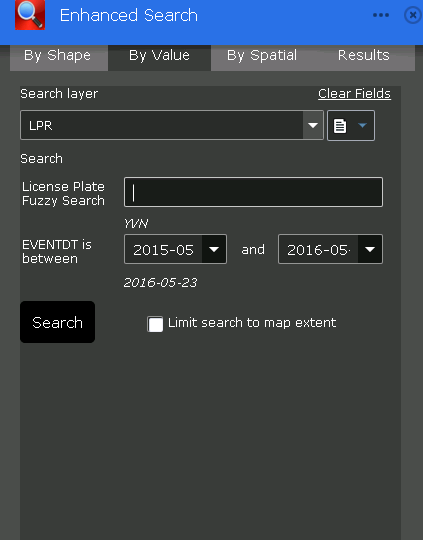

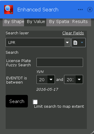

Hello Robert,
I'm using your latest enhanced search widget for a web app builder (version 2.0) app that I've created. Your latest updated widget works great. I just had a few questions that I hope you can answer below:
     1.) I'm using 2 search expressions as you can see below. One is a fuzzy license plate search and the other is the date ranges. Is there a way that I can have the start date default to it always being today's date -365 days? Currently, both the start & end dates are today's date. The dataset this is referencing only goes back 1 year per our retention policy.
2.) Is there a way for me to expand the size of this widget window when it loads? The date windows are cut off so it doesn't show the full date on initial load. I realize this will show up differently depending on users screen resolution.
3.) Can I have the "Limit search to map extent" option checked on by default?
Thank you in advance for any guidance you can provide,
Mike
RobertScheitlin__GISP
MVP Emeritus
Michael,
1. Currently no. You are the second person to ask in the last couple of week so I need to really look into this possibility.
2. The default size of the widget is theme dependent. It looks like you are using the Dart Theme, and the Dart theme and the launchpad theme ignores any height and width values set in the main config.
3. Sure there is a setting for this at the bottom of the main settings page "Enable limit results to maps extent by default".
#2 additional info
You can make some code change to make the dart theme use the position height and width properties from the main config.

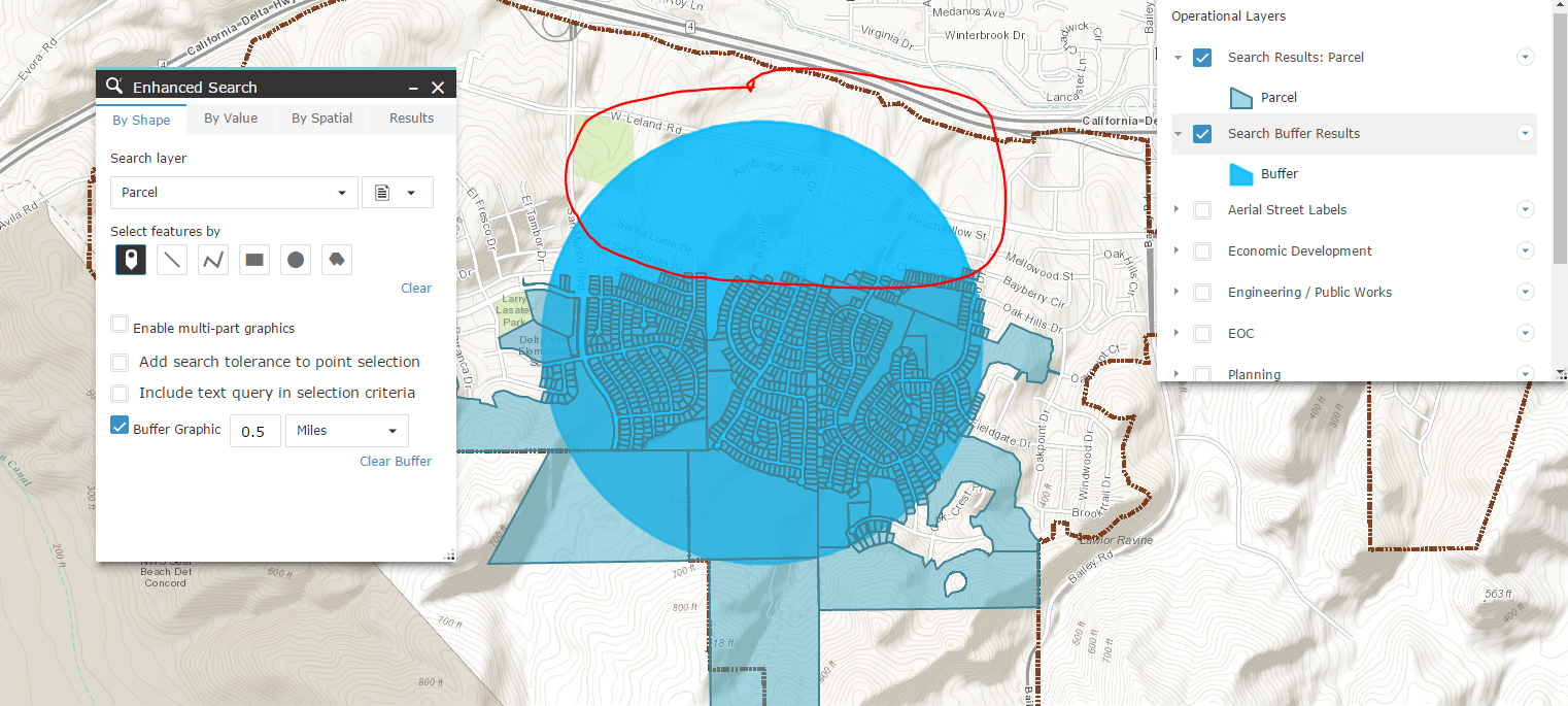

ShitalDhakal__GISP
Hi Robert Scheitlin, GISP, A colleague of mine encountered something interesting this morning while using the 'buffer' in enhanced search widget this morning that I wanted to bring your attention to.
On using a small buffer radius like 0.2 mile from a point, we could select all the parcels in the proximity. But on using a buffer distance of 0.5 miles, the tool does not select all parcels within the radius.  I haven't set any maximum buffer distance in the widget. Any thoughts on why this is happening?
Again, thank you for your time in advance.

I believe by default there is a 1000 record limit on returned records for performance which is what you might be hitting when going from 0.2 to 0.5 miles.  You can increase this limit on the mapservice, but it could negatively impact your apps performance so you would want to test it out first.
MVP Emeritus
Shital,
Michael is correct it appears you are hitting the 1000 record limit on your map service.
ShitalDhakal__GISP
Thanks for the reply Michael and Robert. It indeed was the record limit issue.
For someone struggling with similar issue, here are the steps to increase the limit:
  1. Log into ArcGIS Server Manager and find the map service you are interested in.
  2. When you find the service, click on the pencil icon next to the service name which lets you edit the service details.
  3. When editing the service, click on the tab on the left which says "Parameters" and then there is a setting under properties called "Maximum number of records returned by server" - you should be able to change the value there. By default, the number is 1000.
  4. Select "Save and Restart" when done editing to save the saves and restart the service.

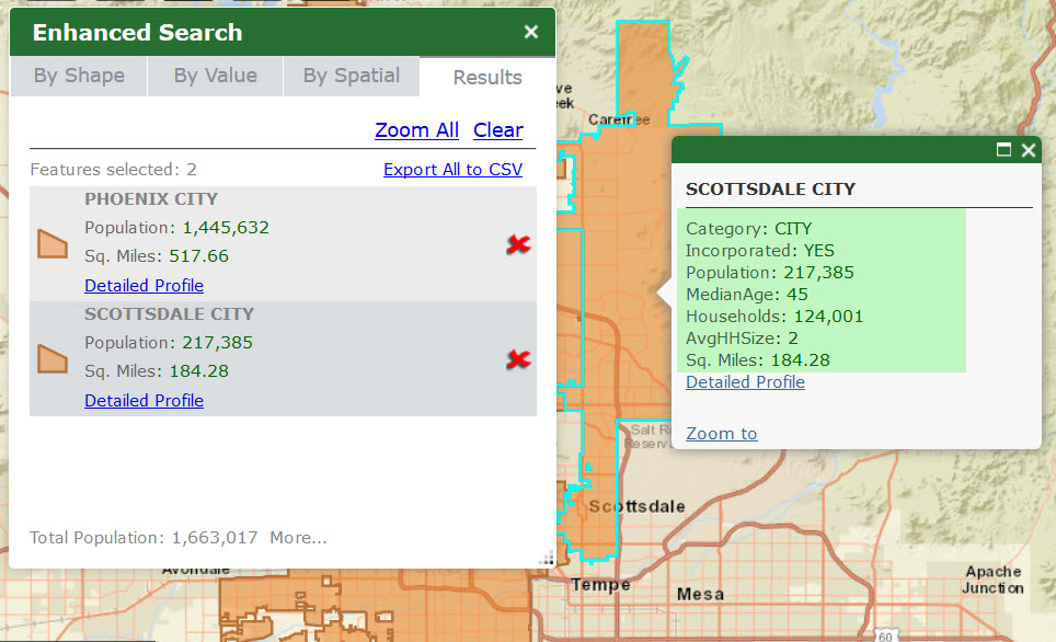

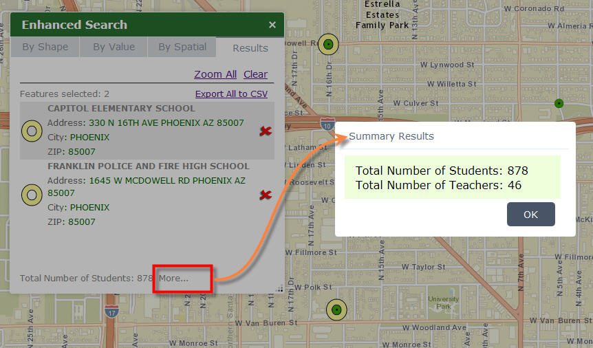

The ability to display the sum of more than 1 numeric fields will come in very handy.
Here I am displaying the Total Number of Students, and Teachers from the selected schools.
I can easily display the Total Population from selected cities:
I can press the More option to see more summary results:
This is a brilliant enhancement.

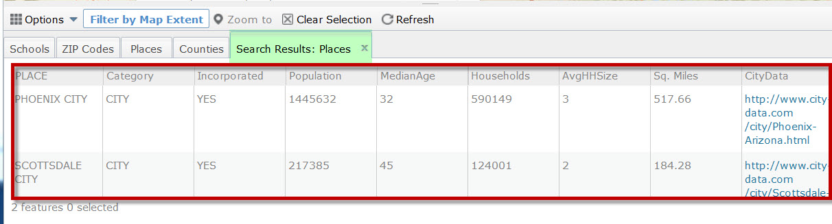

When you click on a record, the Pop-up window shows the complete list of attributes.
I like the Export All to CSV link right on the Results pane.
However, only the items in the Results pane were exported.
PLACE
Population
Sq. Miles
The values from the items in the Pop-up window did not make it through:
Category
Incorporated
MedianAge
AvgHHSize
CityData – This is the hyperlink field

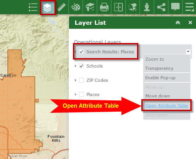

Let’s see how the Export All to CSV link behaves in the Attribute Table.
Open Attribute Table from Layer = Search Results: Places
All the attributes are displayed:
Click on the Export All to CSV link from the Options pull down:
Now I see all the item values exported correctly.
I would like to submit an enhancement request to make the Export All to CSV link on the Results pane behave the same way as the Export All to CSV link on the Attribute Table.

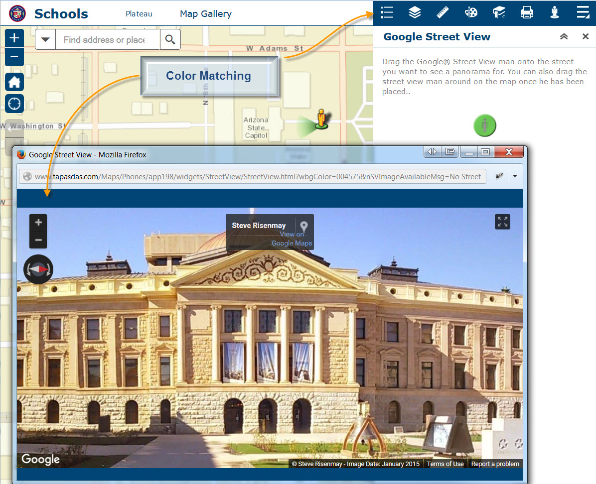

Thanks for the quick fix on making the Identify Title to appear in black in the Launchpad Theme.
http://www.tapasdas.com/Maps/Phones/app192/
The Title is now readable in Black
As per your instructions, I added these two lines to the very end of the \server\apps\App#\widgets\Identify\css\style.css file:
.claro .jimu-launchpad-panel .identify-list-item .title {
  color: black;
All your custom widgets now match the Style Colors in the new Plateau Theme.
http://www.tapasdas.com/Maps/Phones/app198/
I was examining your eSearch Widget to see how made this color matching possible.
\server\apps\App#\widgets\eSearch\css\style.css
You had to write 1382 lines of CSS code to color match all your controls to each Style Color in each of the 8 Themes.
This is an incredible amount of work!
I admire your patience.

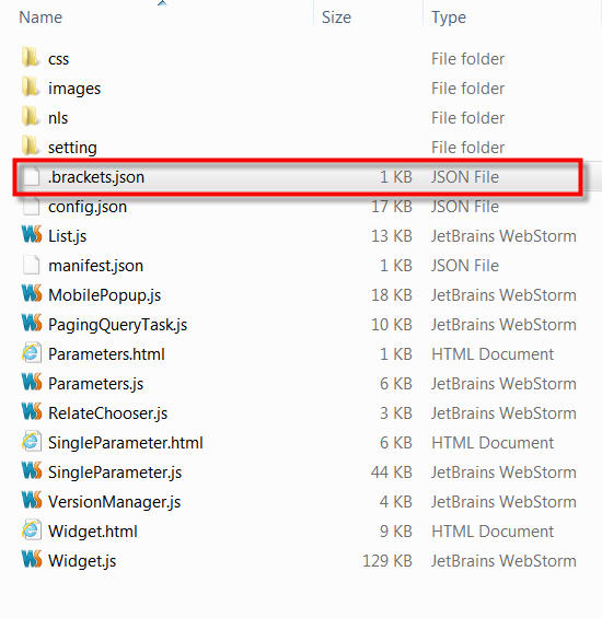

I saw one file named .brackets.json
Does this file need to be there?

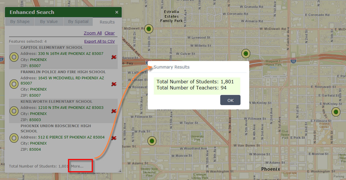

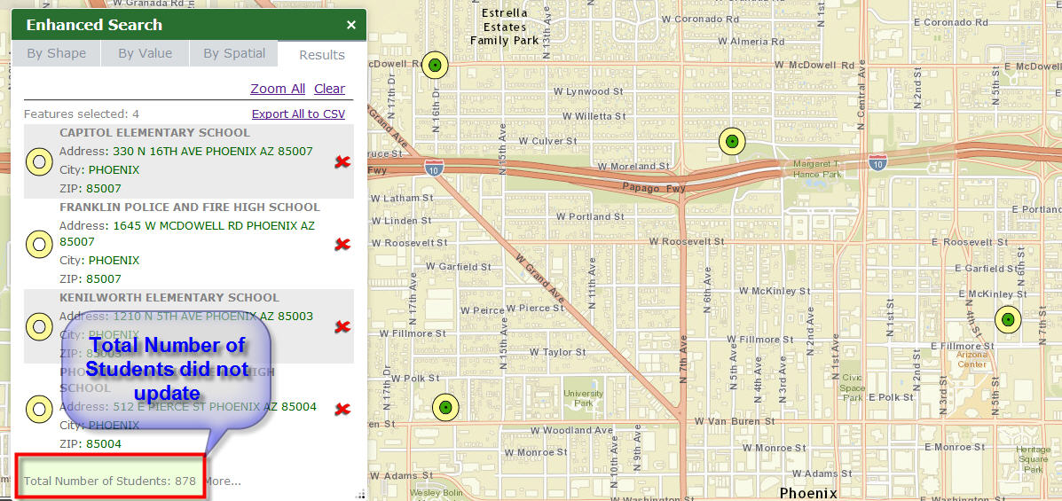

I have an enhancement request on how the Summary Results are displayed when you add to the selection set in Enhanced Search Widget 2.0.1.4
I will explain this through a simple test case.

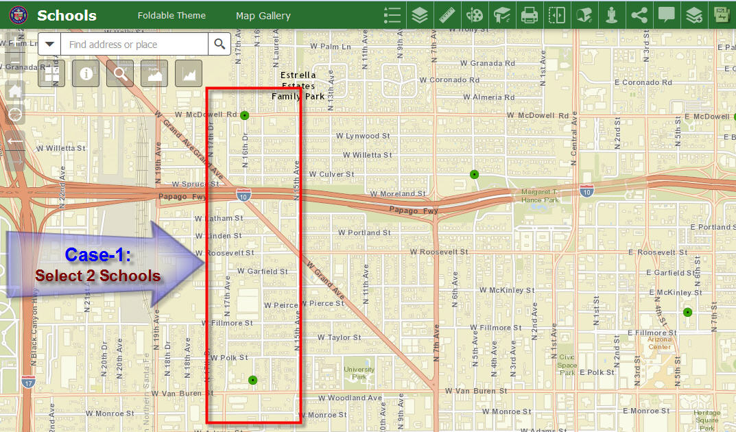

Open the Foldable Theme using eSearch 2.0.1.4
http://www.tapasdas.com/Maps/Phones/app191
I want to display the Summary Results for 2 Schools.
Open the Enhanced Search Widget and select 2 Schools.
The Summary Results correctly displays the Total Number of Students and Teachers.
Now, what if I want to add 2 more Schools to my Selection Set?
Set the Selection Mode to Add to Current Results, and lasso 2 more Schools.
The Results Pane now correctly shows 4 Schools.
However, the Total Number of Students displayed in the bottom did not update.
It is still showing the Total Number of Students = 878 from the first selection.

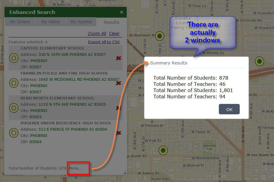

When I click on the [More...] button, I get 2 Summary Results Windows.
The first two lines shows the Summary Results from the initial section of 2 schools.
The last two lines shows the Summary Results after adding to the selection.
This can be confusing.
I was expecting to see 1 Summary Results Window like so:
Summary Results:
Total Number of Students: 1,801
Total Number of Teachers: 94

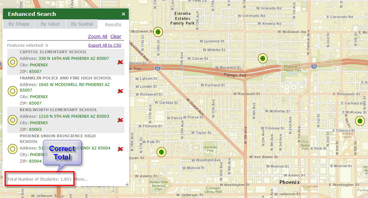

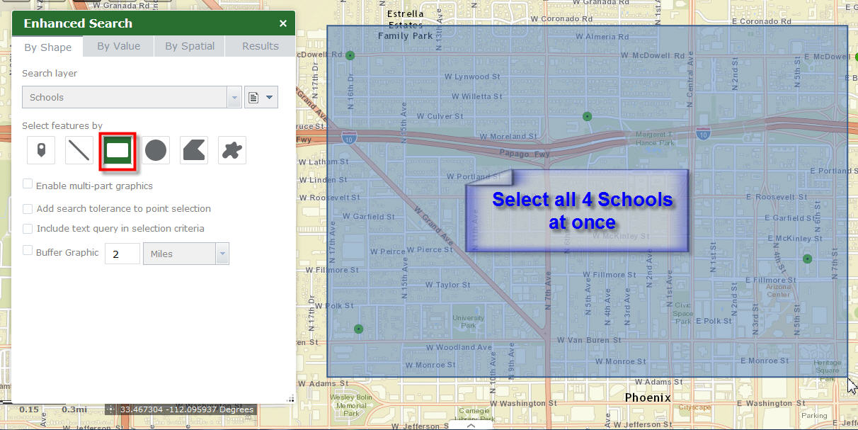

If I refresh the map, and make a new selection to select the 4 Schools like so:
I get the correct total displayed at the bottom.
When I click on the [More...] button, I get 1 Summary Results window showing the correct totals:
MVP Emeritus
Tapas,
    I agrees that the multiple sums needs some work. The way that it is currently working is NOT what I had intended. The text at the bottom of the widget should update and the summary window should only show the full sum, not two sets of sums. I will get this fixed for the next release. The CSV export is not working as intended either as any field whether popup only or the main eSearch results. You should not have a column listed in the exported CSV that has no data in that column.
Rod Woodford​ I don't think Tapas was suggesting that all the map services columns would be exported, but just the columns and data included in the search results and any used in the popups.

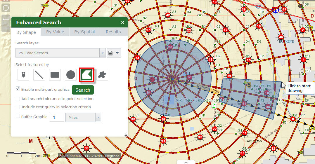

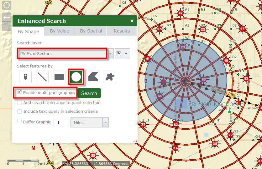

DAVIDDAS1
Hi Robert,

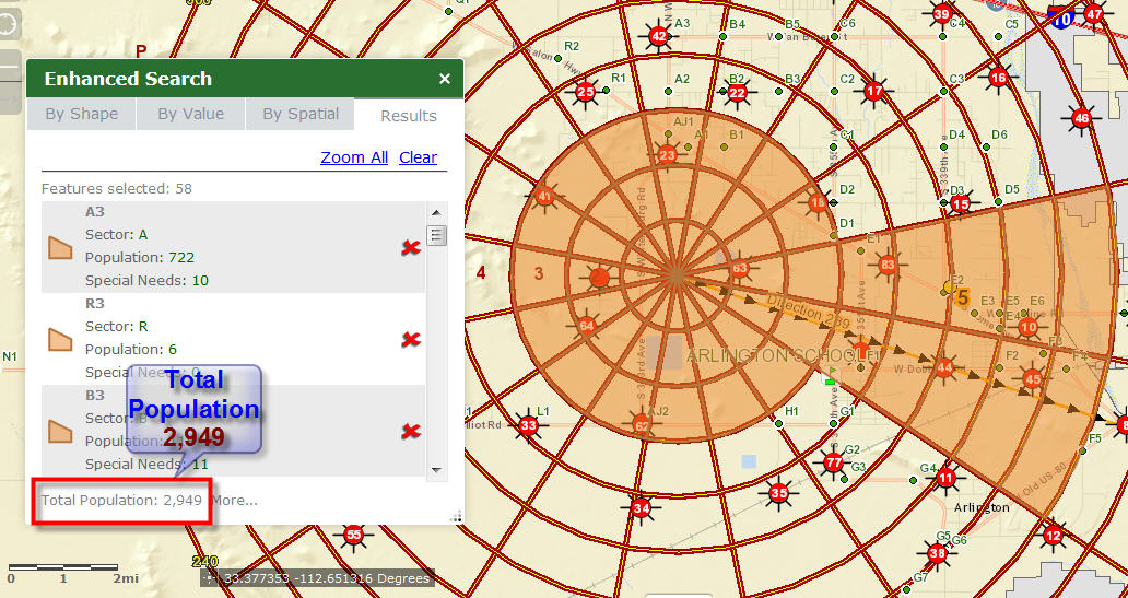

The ability to display the sum multiple fields combined with the capability of selecting multi-part graphics in eSearch 2.0.1.4 gave us the perfect solution we needed in one of our Emergency Management applications.
We needed a quick and efficient way of finding the number of people, cats, and dogs that need to be evacuated in an emergency.
A typical situation may call for everyone to be evacuated within 3 miles of ground zero, plus an additional number that may lie 8 miles along the wind vector.
This is where multi-part graphics comes in real handy to define the affected evacuation sectors.
First I am using the Circle Tool to select all sectors within 3 miles of ground zero.
Next, I am using the Polygon Tool to select the evacuation sectors 8 miles along the wind vector.
When I press the Search button, I get the contamination area highlighted in orange.
The Total Population that needs to be evacuated is shown in the bottom of the Results Pane.
When I click on the [More...] button, I get the full summary results.
This is the quickest way to display how may persons, people with special needs, cats, dogs, etc., that need to be evacuated in an emergency where every minute counts.
As you can see, the ability to display the sum of multiple items was critical for our emergency app.
It now works like a dream!
