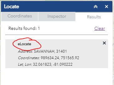

Hi Robert,
Thanks for this great widget. I am having an issue with the "Inspect Address" tool - in the title where the address should be, I instead see "eLocate". This only occurs for locators created in ArcGIS Pro using the "POI" role. Is this something that can be fixed within the widget JS file?
RobertScheitlin__GISP
MVP Emeritus
@AnnaStam,
   That is the default behavior when the locator does not provide a address. This widget is not been designed or tested to work with POI locators from Pro.  I could possibly provide to code change guidance if your locator is public for me to access and test against.
AnnaStam
@RobertScheitlin__GISP, that would be wonderful. The locator is public and available here: https://public.sagis.org/arcgis/rest/services/Locators_Pro/MAD_POI_FullAddress/GeocodeServer
The "Point of Interest" is mapped to our Full Address field.

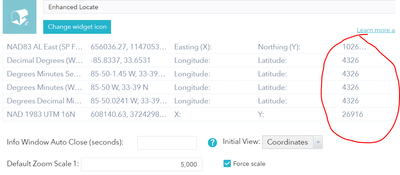

Is there a new version of this, trying to add to Webapp Builder 2.20. When trying to configure the widget and add a map coordinate unit I get an error. Regardless of what WKID I put in the text input will remove the text and the text box becomes red. So I am unable to add a new coordinate system.
Error Message using developer tools.
Any help would be appreciated.
Thanks,
Jason
MVP Emeritus
@JasonLee9
This is a bug in WAB since 2.13 or earlier. The Fix is noted in this thread.
https://community.esri.com/t5/web-appbuilder-custom-widgets-documents/enhanced-locate-widget-version...
JasonLee9
Robert,
Thanks for the fast response. Yes, updating the wkidDetails.json file did the trick. It is working now!

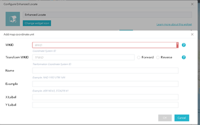

KearaMcKay1
Hi Robert,
I'm having a similar issue with not being able to add in the WKID when adding my own map coordinate unit. However I've added the tool as an appbuilder extension to my portal, so the custom widgets can be added into the portal web app builder (not dev edition) so where would you advise I add the new JSON to? I see it in the folder; Portal\apps\webappbuilder\stemapp\jimu.js\SpatialReference
any help is greatly appreciated!
MVP Emeritus
@KearaMcKay1
I am not a portal user but that looks like the right path.
Aneel_Kumar_M
Dear Robert,
Thank you so much its a very good tool, unfortunately, I am not able to overcome this.
I am working from middle east, somehow, i am not able to download this file.
But I downloaded from the below site and tried also, unsuccessful 😞

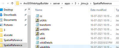

https://dportalgis.vivienda.gob.pe:8443/app_dgppvu/dgppvu/VisorCRP/jimu.js/SpatialReference/
then, I tried modifying and use the json files, I tried both formats shown below, I modified and kept only WKID which are required for me.
--------------------1---------------------------------
"wkids":[3440,3857,4326,32640],
"labels":["PDO_1993_UTM_Zone_40N", "WGS_1984_Web_Mercator_Auxiliary_Sphere","GCS_WGS_1984", "WGS_1984_UTM_Zone_40N"],
"details":["PROJCS[\"PDO_1993_UTM_Zone_40N\",GEOGCS[\"GCS_PDO_1993\",DATUM[\"D_PDO_1993\",SPHEROID[\"Clarke_1880_RGS\",6378249.145,293.465]],PRIMEM[\"Greenwich\",0.0],UNIT[\"Degree\",0.0174532925199433]],PROJECTION[\"Transverse_Mercator\"],PARAMETER[\"False_Easting\",500000.0],PARAMETER[\"False_Northing\",0.0],PARAMETER[\"Central_Meridian\",57.0],PARAMETER[\"Scale_Factor\",0.9996],PARAMETER[\"Latitude_Of_Origin\",0.0],UNIT[\"Meter\",1.0]]","PROJCS[\"WGS_1984_Web_Mercator_Auxiliary_Sphere\",GEOGCS[\"GCS_WGS_1984\",DATUM[\"D_WGS_1984\",SPHEROID[\"WGS_1984\",6378137.0,298.257223563]],PRIMEM[\"Greenwich\",0.0],UNIT[\"Degree\",0.0174532925199433]],PROJECTION[\"Mercator_Auxiliary_Sphere\"],PARAMETER[\"False_Easting\",0.0],PARAMETER[\"False_Northing\",0.0],PARAMETER[\"Central_Meridian\",0.0],PARAMETER[\"Standard_Parallel_1\",0.0],PARAMETER[\"Auxiliary_Sphere_Type\",0.0],UNIT[\"Meter\",1.0]]","GEOGCS[\"GCS_WGS_1984\",DATUM[\"D_WGS_1984\",SPHEROID[\"WGS_1984\",6378137.0,298.257223563]],PRIMEM[\"Greenwich\",0.0],UNIT[\"Degree\",0.0174532925199433]]","PROJCS[\"WGS_1984_UTM_Zone_40N\",GEOGCS[\"GCS_WGS_1984\",DATUM[\"D_WGS_1984\",SPHEROID[\"WGS_1984\",6378137.0,298.257223563]],PRIMEM[\"Greenwich\",0.0],UNIT[\"Degree\",0.0174532925199433]],PROJECTION[\"Transverse_Mercator\"],PARAMETER[\"False_Easting\",500000.0],PARAMETER[\"False_Northing\",0.0],PARAMETER[\"Central_Meridian\",57.0],PARAMETER[\"Scale_Factor\",0.9996],PARAMETER[\"Latitude_Of_Origin\",0.0],UNIT[\"Meter\",1.0]]"]
second format
-------------------------2---------------------------
"details":["PROJCS['PDO_1993_UTM_Zone_40N',GEOGCS['GCS_PDO_1993',DATUM['D_PDO_1993',SPHEROID['Clarke_1880_RGS',6378249.145,293.465]],PRIMEM['Greenwich',0.0],UNIT['Degree',0.0174532925199433]],PROJECTION['Transverse_Mercator'],PARAMETER['False_Easting',500000.0],PARAMETER['False_Northing',0.0],PARAMETER['Central_Meridian',57.0],PARAMETER['Scale_Factor',0.9996],PARAMETER['Latitude_Of_Origin',0.0],UNIT['Meter',1.0]]","PROJCS['WGS_1984_Web_Mercator_Auxiliary_Sphere',GEOGCS['GCS_WGS_1984',DATUM['D_WGS_1984',SPHEROID['WGS_1984',6378137.0,298.257223563]],PRIMEM['Greenwich',0.0],UNIT['Degree',0.0174532925199433]],PROJECTION['Mercator_Auxiliary_Sphere'],PARAMETER['False_Easting',0.0],PARAMETER['False_Northing',0.0],PARAMETER['Central_Meridian',0.0],PARAMETER['Standard_Parallel_1',0.0],PARAMETER['Auxiliary_Sphere_Type',0.0],UNIT['Meter',1.0]]","GEOGCS['GCS_WGS_1984',DATUM['D_WGS_1984',SPHEROID['WGS_1984',6378137.0,298.257223563]],PRIMEM['Greenwich',0.0],UNIT['Degree',0.0174532925199433]]","PROJCS['WGS_1984_UTM_Zone_40N',GEOGCS['GCS_WGS_1984',DATUM['D_WGS_1984',SPHEROID['WGS_1984',6378137.0,298.257223563]],PRIMEM['Greenwich',0.0],UNIT['Degree',0.0174532925199433]],PROJECTION['Transverse_Mercator'],PARAMETER['False_Easting',500000.0],PARAMETER['False_Northing',0.0],PARAMETER['Central_Meridian',57.0],PARAMETER['Scale_Factor',0.9996],PARAMETER['Latitude_Of_Origin',0.0],UNIT['Meter',1.0]]"]
I copied it in my [Install dir]
"C:\WebAppBuilder\ArcGISWebAppBuilder\server\apps\3\jimu.js\SpatialReference"
above shown both formats, I tried, somehow, it did not work.
Lastly, Is it possible for you to Just add two WKID  (3440,32640) in the tool kit itself and upload the ZIP file, i will strait away use it.
So that it will be shown directly here
Could you please add these and upload zip file.
Looking forward to your help and I appreciate your support and help.

@Aneel_Kumar_M
The file that you are having trouble downloading from my web server has been uploaded to esri's web server now. You will find the wkidDetails.json zip file in the downloads section above. That should resolve all you issues and you can configure your desired spatial references using the widgets settings dialogs.
Aneel_Kumar_M
Thanks for the prompt reply, please share the hyperlink, it would be great help to me and others too.
MVP Emeritus
@Aneel_Kumar_M
As I mentioned in my post to you the file you need is now located above along with the widget download.
Aneel_Kumar_M
Got it, thank you. I downloaded and copied in
Unfortunately, still not working.
For testing, I try to add the wkid which is already in the list, but still same issue., I cant go next field, Transform WKID or Name, the WKID deletes and give same error.

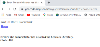

Is this tool works for portal? or only AGOL ?
https://geocode.arcgis.com/arcgis/rest/services/World/GeocodeServer
Is this error linked to my below problem ?
I appreciate your support.

@Aneel_Kumar_M  To answer your question about Portal or AGOL this custom widget will only work in WAB Developer or Portal. Custom widgets are not allowed in AGOL. As far as version of WAB 2.21 or 2.24 either will work.
After you overwrote the wkidDetails.json file in the jimu client and the app folder that you are configuring the eLocate widget in did you restart and clear your browsers cache?
Aneel_Kumar_M
Dear Robert,
  1. I opened the application, removed the already configured tool
  2. saved and closed the bowser
  3. then opened the browser, then cleared the cache
  4. I gain added the tool to my application and saved
  5. then I tried to edit for changing the existing SR or to add new SR
  6. I got the same issue. is there anything else I need to do?
please advise, thank you for your support.

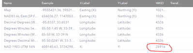

MVP Emeritus
@Aneel_Kumar_M  I am not sure what this issue is then. So the advice I have now is to just manually make the changes to the widgets json.
Open server\apps\3\configs\eLocate\config__x.json and change the wkid of the last point unit object (i.e.
        "wgs84option": "",
        "wkid": 26916,
        "ylabel": "Y:",
        "xlabel": "X:",
        "example": "608140.63, 3724298.41",
        "name": "NAD 1983 UTM 16N"
to whatever wkid you are wanting and change the example and name properties as well. Restart WAB and you should be good to go.
Aneel_Kumar_M
Dear Robert,
Great, it worked, thank you so much.
Though, it was popping up permission error, for editing the config file, I try to edit in my local and overwrite it, but still file was not able to replace. So I did the below steps.
  1. Removed from the web app and saved it
  2. modified the config file in the eLocate widget folder
  3. Then added in to the web app
  4. tested and Its working now
I appreciate your continuous support.

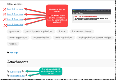

IF ANYONE KNOWS or HAS VERSION 2.9. Please SHARE IT / upload it to this original thread 👇
Enhanced Locate Widget Version 2.16 - 08/21/2020
https://community.esri.com/t5/web-appbuilder-custom-widgets-documents/enhanced-locate-widget-version....
All the original links are broken.
I will tag @RobertScheitlin__GISP but I saw he has not logged on to the ESRI community since February of 2025.
Any help from the ESRI Community and this group would be greatly appreciated!
@Aneel_Kumar_M (by any chance do you still have it?)Looks like you were one of the last people in 2022 that communicated to Robert on this.
Thank you everyone in advance for your help!
jcokin1
The links have been repaired! Thank you @RobertScheitlin__GISP! Can download version 2.9. 👍
