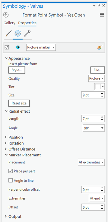

Alright well, here's the workaround I came up with if anyone reading this is having the same problem.
What I did was add a "Radial Effect" and place the valve symbols at the endpoint of this "arm". By changing the radial length I can adjust the spacing of these symbols.
Here are the specifics for the symbology:

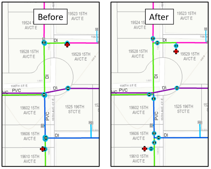

I did the same for our "Hydrants" and "Control Valves" layers. They all have to have a symbol rotation field for this to work. It's not perfect (in areas with a lot of features it's still a confusing mess) but it's an improvement. See the before and after for a 1 in = 100 ft scale map:
Unfortunately it's not feasible for us to go all-online. We still need to create static, paper maps for a variety of situations.
