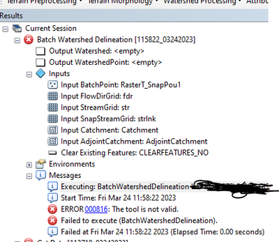

Still running into issues with trying to delineate.
Tried to use GIS basic 10.7 thinking if I went with a simpler model I could a least calculate polygons, and then move them into Pro. I am just lost for a solution here.
Any suggestions would be appreciated.

SOLUTION:
After working with @ChristineDartiguenave on this, we discovered that my Pro was outdated and needed to be upgraded to 3.0 in order to use the proper archydro tools (with an additional upgrade to archydro).
Additionally, Utilizing the Stormwater Utility Network (downloadable via esri) was able to provide the process/details I needed to complete my delineations. There are "stormwater processing" and "stormwater delineation" tools available in archydro that you need to have S.U.N. in order to process.

I’ve not used Pro yet.
I see “tool is not valid” in the error messages. Do you have all of the required Python modules installed?  I assume ArcPy is a standard instal with ESRI products, but are there others? I’ve never had to worry about that as my Programmer Analyst sets up the installations for me.

AliMcLeod
My in-house IT has installed everything available both on Pro and ArcMap 10.7 (and 10.8) -- we can get all data to run up to the adjoint catchment--- after that, it stops functioning properly.
Point delineation and watershed delineation methods both do not work.
He is going to contact ArcGIS help desk, but our company license holder is on vacation, so it will have to wait until he returns. I was hoping there was a workaround- because *of course* we have an end of month deadline for this project and need this delineation information for said deadline.
I am nearing the point of using stream-stats and going through and individually geo-locating my culverts to get the data one by one but would REALLY like to avoid that due to the potentially large amount of error involved.

Seems if you can get to adjoint catchment you’ve gotten past the full sinks step. Have you?

AliMcLeod
SOLUTION:
