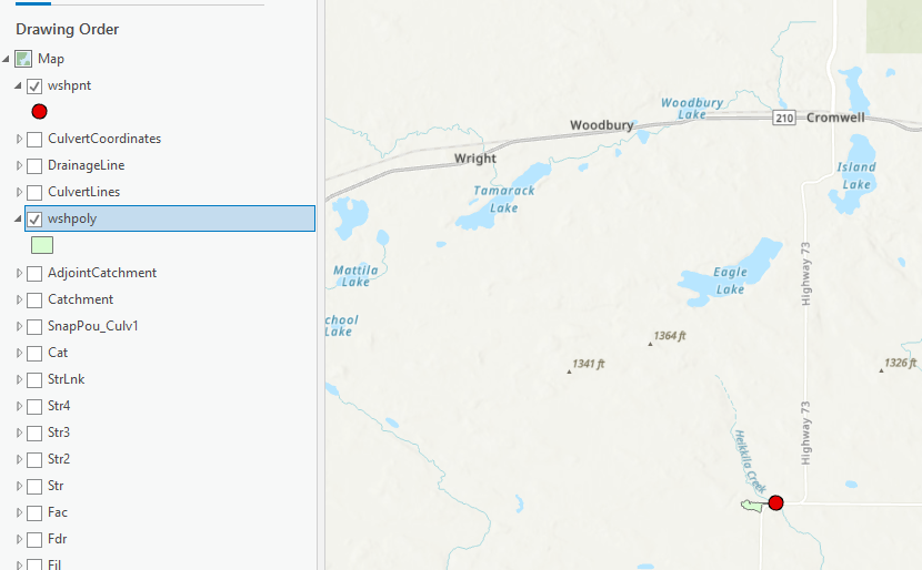

Hi All- I am stuck with delineating a watershed. I have archydro toolbox downloaded and I use it as much as possible instead of spatial analyst. I have approximately 40 culverts along a 15mile length of road that have been 'burned' into a DEM. I have snapped them to the stream link, and I ensured all streams crossed the road/were nearby the culverts prior to creating the streamlink (number of cells defined at 1500).  Catchment, adjoint catchment, drainage line, and drainage points all look to be correct.

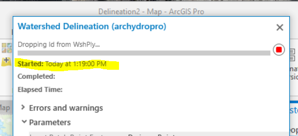

When I use Point Delineator, it chooses a single culvert point and delineates a tiny subwatershed (even smaller than the catchment polygon). When I use Watershed Delineation, it just cycles between "droping id" to "processed 0 features" to "final selection" to "sampling" to "100%" and back. It never finishes, and this has ran for three plus hours with no results.

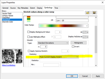

I'm still in ArcMap, not Pro. With either version you should be able to symbolize the color ramp on the DEM to view the statistics "From Current Display Extent" (see first image). This allows you to see the subtle differences in the DEM no matter what your zoom level.

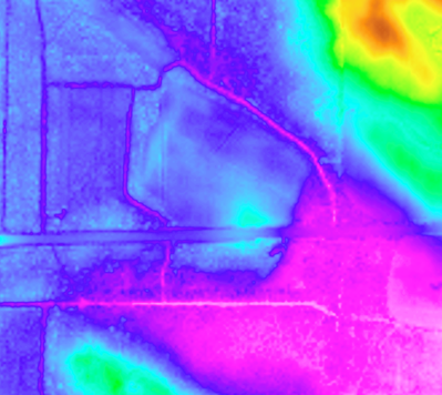

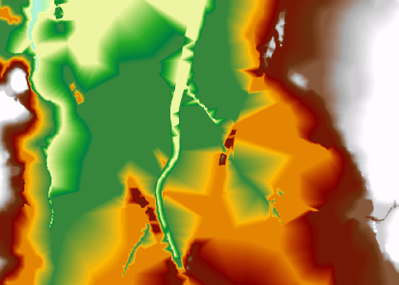

The second image below is a portion of our County  DEM with this setting. The third image is a zoom in on what looks flat. The color ramp adjusts for the the data in that view revealing more detail.
You should be able to study parts of your DEM to tell if burning the streams is needed, especially where you are getting the small watersheds.

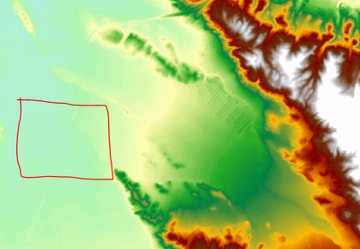

but--  This is the zoomed out:

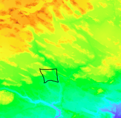

this is the zoomed in DEM:
So, this is why I am at an utter loss and confusion! I feel like all the steps I am taking SHOULD yield results. Yet, for some reason- I am coming up empty handed. And like you said earlier, if I am getting correct adjoint catchments, then the data is there and pulling appropriately.

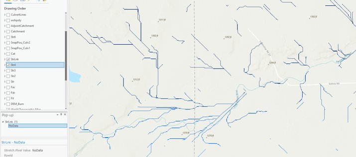

After digging even deeper into the data, I may have discovered the problem. For some reason, my stream and stream links are not connecting the paths together- and when I turn on the drainage line layer- that feature class is just line data of these two rasters overlapping.
So how do i get one solid stream network to appear, and not have the mainstream itself become disconnected? (Str was a cell size of 500, Str2 was 1000, Str3 was 1200, and Str4 was 1500; StrLnk was created from Str4)
