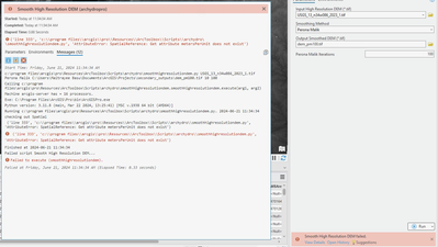

Hello everyone,
I am working on the Archydro toolset and I am facing an issue with the perona malik smoothing method, the mean and median areworking normally but the perona malik is not working and showing the error below.
(I am using the DEM I generated from the LAS file data)

Hello @HusamAbuOqer ! Perona Malik requires the input DEM to be in the .tif format. While other formats may work with the other smoothing methods, it is highly recommended that .tif files be used as inputs anyway. Please let me know if this resolves your issue. Thanks!

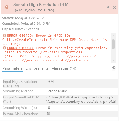

Hello. I am receiving this error when attempting to use Perona Malik method. It is is TIFF format, 1m resolution. Any insight would be helpful.
LeAnnaKilhoffer
I am receiving the same error as you with 3 meter DEM data downloaded from the USGS. However if I run the smooth high resolution DEM tool on a higher resolution DEM I get a different error. Any ideas on what I can do to fix these errors.
