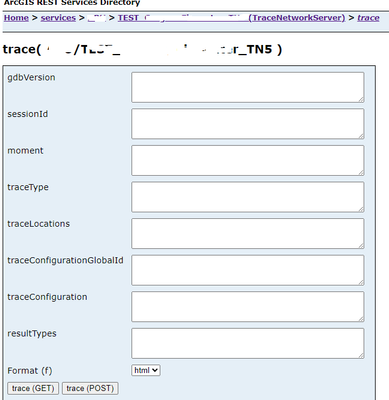

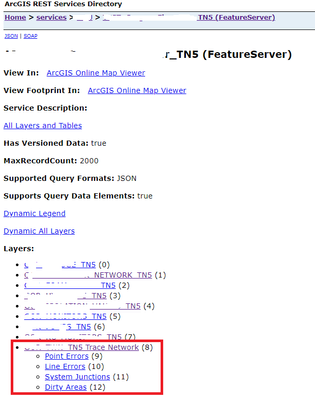

I've had another crack at this issue through python code. Dose anyone know how to access the feature service relating to the Trace Network through AGS Server. I can access all the services through portal that make up the Trace Network with the exception of the Trace Network which is not shown in portal?
Or does anyone know how to implement the (TraceNetworkServer)?
  • esriJobMessageTypeError: Traceback (most recent call last): File "E:\arcgisserver\directories\arcgissystem\arcgisinput\ABU\tokenAccess.GPServer\extracted\cd\firewater\test.py", line 48, in <module> arcpy.tn.Trace(in_trace_network=trace_network,trace_type="CONNECTED",starting_points=sor,barriers=barriers,path_direction="NO_DIRECTION",shortest_path_network_attribute_name="",include_barriers="INCLUDE_BARRIERS",validate_consistency="VALIDATE_CONSISTENCY",ignore_barriers_at_starting_points="DO_NOT_IGNORE_BARRIERS_AT_STARTING_POINTS",allow_indeterminate_flow="IGNORE_INDETERMINATE_FLOW",condition_barriers=None,function_barriers=None,traversability_scope="BOTH_JUNCTIONS_AND_EDGES",functions=None,output_conditions=None,result_types="AGGREGATED_GEOMETRY",selection_type="NEW_SELECTION",clear_all_previous_trace_results="CLEAR_ALL_PREVIOUS_TRACE_RESULTS",trace_name="TEST",aggregated_points=trace_points,aggregated_lines=trace_lines,out_network_layer=None,use_trace_config="DO_NOT_USE_TRACE_CONFIGURATION",trace_config_name="",out_json_file=None) File "E:\ArcGIS\Server\framework\runtime\ArcGIS\Resources\ArcPy\arcpy\tn.py", line 671, in Trace raise e File "E:\ArcGIS\Server\framework\runtime\ArcGIS\Resources\ArcPy\arcpy\tn.py", line 668, in Trace retval = convertArcObjectToPythonObject(gp.Trace_tn(*gp_fixargs((in_trace_network, trace_type, starting_points, barriers, path_direction, shortest_path_network_attribute_name, include_barriers, validate_consistency, ignore_barriers_at_starting_points, allow_indeterminate_flow, condition_barriers, function_barriers, traversability_scope, functions, output_conditions, result_types, selection_type, clear_all_previous_trace_results, trace_name, aggregated_points, aggregated_lines, out_network_layer, use_trace_config, trace_config_name, out_json_file), True))) File "E:\ArcGIS\Server\framework\runtime\ArcGIS\Resources\ArcPy\arcpy\geoprocessing\_base.py", line 512, in <lambda> return lambda *args: val(*gp_fixargs(args, True)) arcgisscripting.ExecuteError: ERROR 000228: Cannot open the dataset. Failed to execute (Trace).
