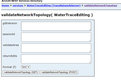

You might also experiment with getting the Validate Topology operation to work directly at the REST Service endpoint on your Enterprise Server and see if you can get it working there first (as in the below screenshot) if you're using an external application to hit the API. If you get it to work here, presumably it should also work by building the API call externally.

Have you successfully had this working on previous versions of Enterprise? We are on 11.3 and it seems to work good for us. You might try including the x and y min and max values, and the spatial reference in the parameter values. Here is an example of the API call that we are using successfully.
https://####/####/rest/services/WaterTraceEditing/TraceNetworkServer/validateNetworkTopology?gdbVersion=sde.default&returnEdits=true&validateArea={ "xmin": -110735560.051509, "ymin": -97670739.797244, "xmax": 127139759.526575, "ymax": 93924216.886155, "spatialReference": { "wkid": 2913, "latestWkid": 2913 } }
