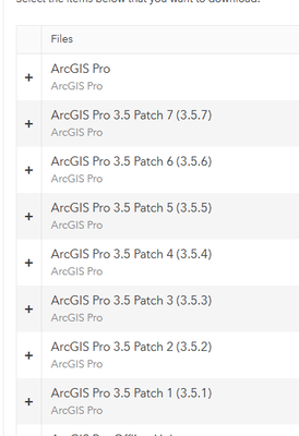

Ok I ran into this duplicate feature creation issue today testing out a Trace Network using Pro 3.5.0.  At first I was glad I found this thread and a link to that bug.  However, ESRI says this bug is fixed in version 3.5.8 ... but of course 3.5.8 is nowhere to be found on myesri.  🤔 What gives?
Suppose I'll try version 3.5.7
