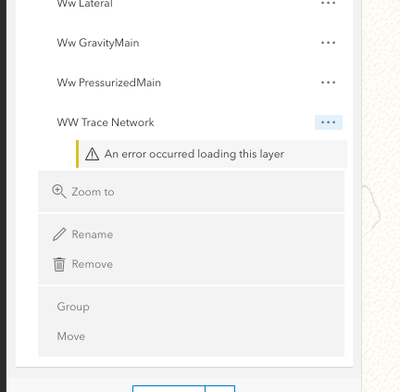

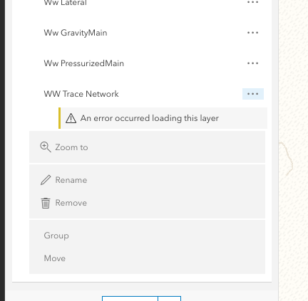

I've published a Trace Network, and I can run traces on it when I  bring it into Pro.
I want to create a field app so crews can run traces in the field. However, when I add the service to a web map, I get an error message in the TOC for the Network layer. No error messages are recorded in the Server or Portal logs.

@AlixVezina - looking at this- from the screenshot above, it appears we can't even view the trace network data  in a web map? Is that correct??
AlixVezina
I think if you add it to a map in ArcGIS Pro and then share that map as a web map to your org, it should work as expected.
VanessaSimps
@AlixVezina So I did what you suggested and it does work, but I am confused- if I can't do traces in web apps and maps, how is this useful for the end user? I ask this out of complete curiosity. I am trying to fully understand functionality and use case here and this is confusing to me. Would staff be able to see traces that I run in desktop? or??
AlixVezina
Right now, there are no plans to support Trace Network specific tools on the web. To trace a Trace Network service, you would need to use ArcGIS Pro.
