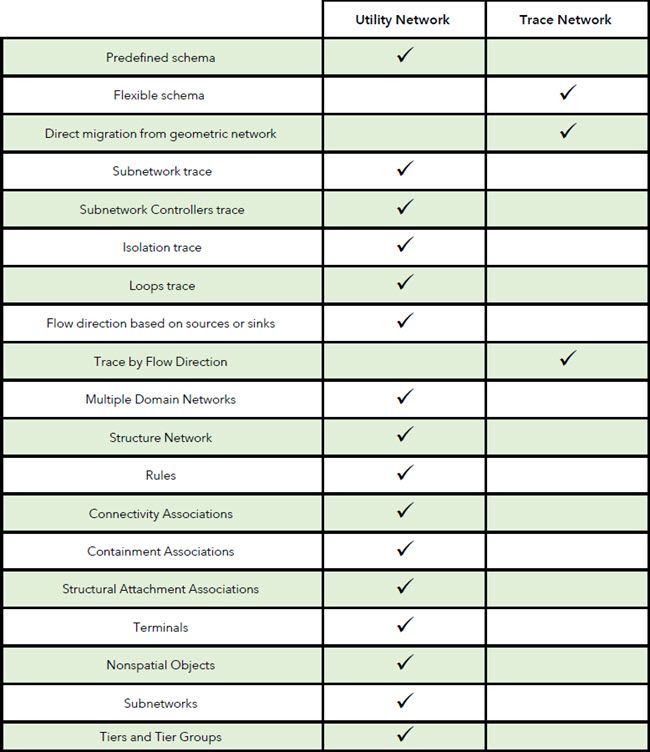

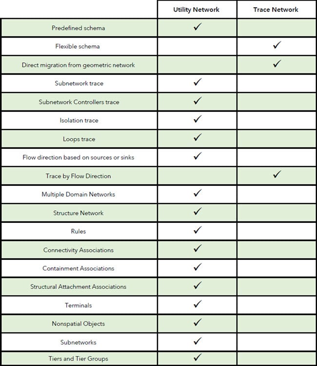

  2. How does the trace network differ from the ArcGIS Utility Network?
There are many similarities between the trace and utility network; however, key differences in functionality are present due to the different use cases targeted for each dataset.  The below table outlines the key pieces of functionality which differentiate the trace network from the utility network with the ArcGIS Pro 2.7 release:
Plans exist to add the following capabilities in later releases:
  • For the trace network:
    • Connectivity and containment associations
  • For the utility network:
    • Trace by Flow Direction
