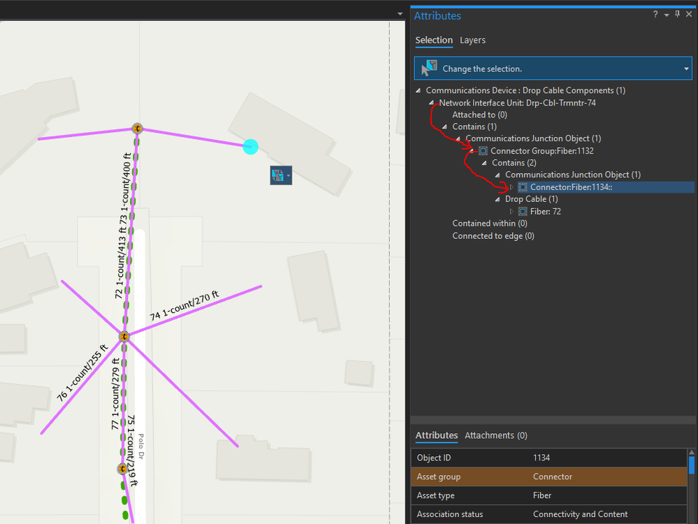

I just want to ask, if network controllers are missing on sample data on version 1.1 intentionally?
I am trying to trace upstream to switch from NIU as described in Task, but in version 1.1 I am getting the error - No valid subnetwork controllers found. The same tracing on version 1.0 works fine.
I know that in the storymap there is a note that as a first steps the creation of subnetwork controller is needed - please could you add also a Task or more detailed steps for this step there?

All the elements in the sample data are fully connected. I think it might be a wrong "Trace Starting Point". Make sure you expand the NIU, then the Connector Group, then select and add the Connector as the starting point.

It seems I had a corrupted project.
Thank you for help.
