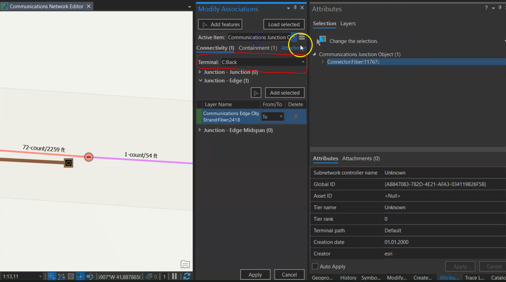

VHolubec
Hi @Anonymous User,
please can you give me any tip how to choose the right connectors/ports?
It seems that the main problem in the previous video was that the all ports/connectors was already use/connected, so I tried it in another Hub.
See the updated video:
(view in My Videos)
There is created  a Drop cable with one strand - 2148. Then back in the Hub, I found that Connector group 12957 containt the created fiber, so assume I have to seelct this - am I right?
Than I selected some port on Patch pane, but still I am not able to make a conenction with the message that No valid junction connection.
Please can you help me once again, what I am doing wrong?
Thank you,
Vladimir

by Anonymous User
Not applicable
Hi Vladimir,
You are getting a step closer to finish the connection!
The only change you have to make is the terminal direction for the connector has to be "Front", in our model, the backside of the fiber/coax/copper connector is always automatically connected to the strand. The "Front" side is for connections within the device.
Once you flip that direction to "Front", it will work.
VHolubec
Thank you so much @Anonymous User!
