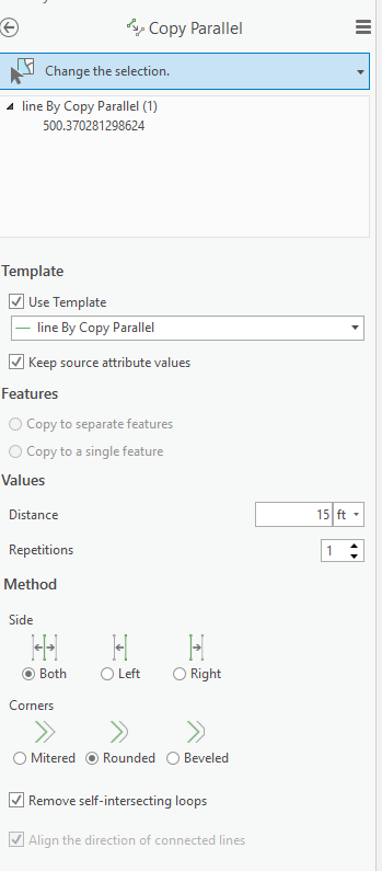

I manually tried to Copy parallel, so i.e. if the amount of ducts was 3, I selected by attribute all line segments with quantity 3 and then copy parallel 2. So 1 was the original line + 2 copied = 3.
What I need to obtain is a new shapefiles where you can see all the ducts (or cables).

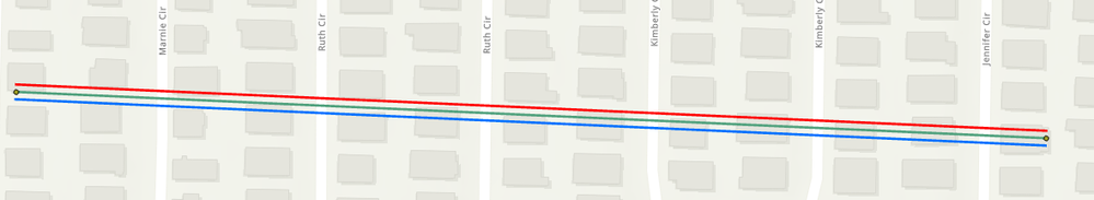

In pic 1 and pic 2 you cans see what I mean but done in a FTTH planning Software. I just was wondering if ArcGIS Pro could do something similar?
Pic 3 shows my attempt by manually copy parallel by selected attribute, but the results is not what I expected, and unfortunally Copy parallel cannot be added to a ModelBuilder.

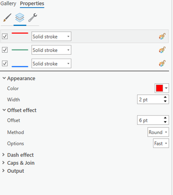

Use Multi-Line Symbology
  • Add additional symbol layers to represent the visualization of the ducts
  • Pros - Simple and easy to create
  • Cons - Only one feature being created, so all the data records are maintained within one row

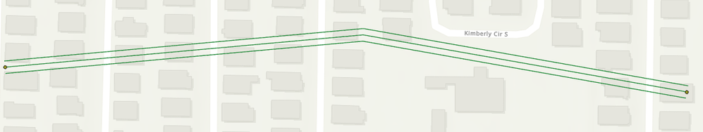

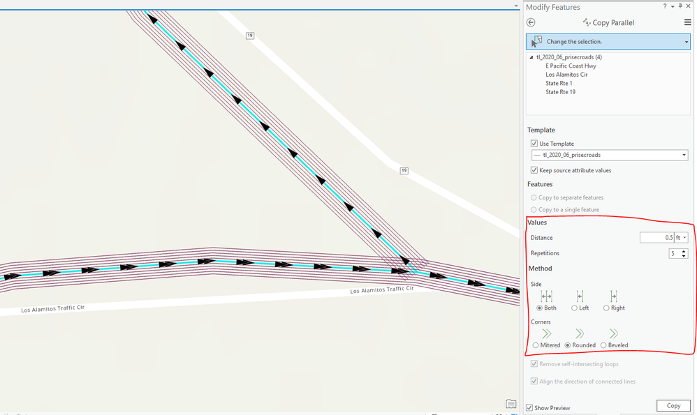

Use Copy Parallel and edit the last vertice
  • Use the "Copy Parallel" tool from the editing toolbox and generate the lines
  • Then use the "edit vertice" tool to modify the end of the line
  • JunJieMa_4-1624315709788.pngJunJieMa_4-1624315709788.pngJunJieMa_5-1624315736838.pngJunJieMa_5-1624315736838.png
  • Pros - Efficient creation of the parall lines at batch with a defined offset, each line is a separate feature
  • Cons - Still need to edit the end vertice to achieve the final visualization

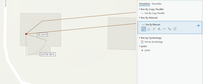

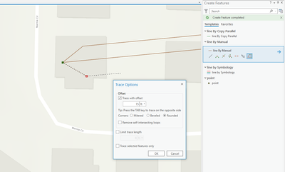

Use Trace Tool and control offset during an editing session
  • This is the most common editing workflow I have seen from our users, but it is also the most manual workflow.
  • Will start from the point and draw a short line to the offset location
  • Then change the editing tool to "Trace", and click "O" from the keyboard to call out the "Trace Option", set the offset distance and other settings before completing the trace.
  • Repeat the same process at the end of the line to add the vertice to close the line at the endpoint.

Out of the three common workflows, I would highly recommend Option 2 since it is much more efficient and you can focus on the editing at the merging point all at once.
Hopefully, these options are helpful for you.

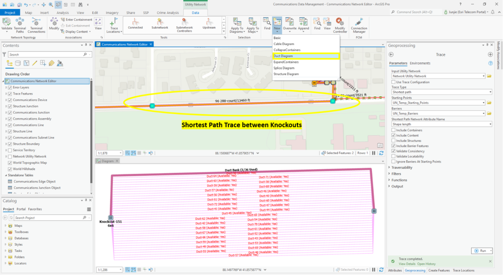

Thank you for your post and it is a common question that we get asked regarding creating offset lines for utilities and telecom cables.
I did check out your pictures for the testing and you are getting very close to making it perfect. I would suggest you to continue adjust the parameters within the tool to achieve what you want from the other fiber planning tool. Please see my attempt below:
And you are right, the "Copy Parallel" tool is currently not available through ArcPy or Modelbuilider. But we do have a technical document explaining how to complete a similar workflow with a customized script. (See Technical Document).
Besides, if you are looking for robust Communications Data Management Solutions via ArcGIS and Solutions, please feel free to check out the Communications Data Management for ArcGIS Enterprise, a foundational template built on top of the Utility Network Management.

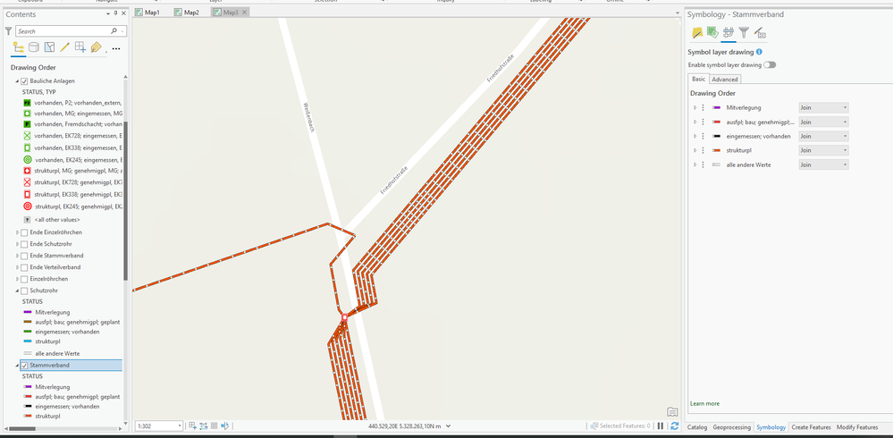

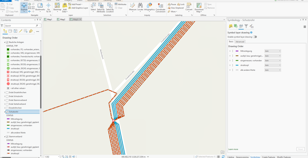

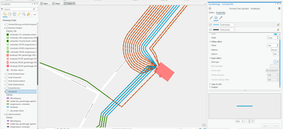

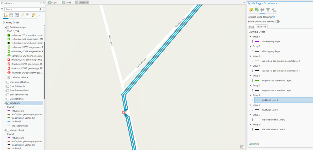

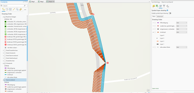

first of all I would like to thank you for your detailed answer, in fact I have checked all the links you advised me to read and found it very interesting. However, I need to ask you a professional opinion, it might help me further.
I have received a .lpk with 2 layers of my interest Schutzrohr (cladding ducts in blue) and Stammverband (feeder ducts in red). You can see in pic 1 and 2 that these look perfectly symmetric, as if they have been generated by a tool similar to copy parallel. But how do you think they have achieved this effect of "confluence" to a single point, in this case a connection point. I measure it out and it really doesn't seem to have been drawn by hand, it is far too perfect.
The wired thing is that I have been told this was obtained with ArcGIS, and obviously didn´t tell me how. I am just braking my head there!
Any ideas? Does any tool in the Network management solve this? Or any tool at all?
