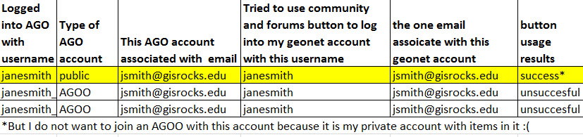

OK I get how the community and forums button works now. I experimented (see image below) and see that I have to be logged into AGO or AGOO with the same username that I want to use in geonet for the community and forums button to work. I was confused because I only use one email but I see that the community and forums button wants to transfer the exact username (and email). So none of my organization attempts were sucessful. Like you said it only wanted a public or organization account with the same username.
Thanks!
Allison
