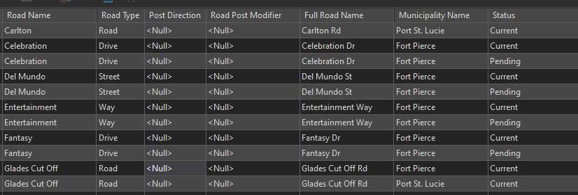

I've been testing out the new Address Data Management solution for ArcGIS Pro 2.5.  I've populated my Master Road Names table based on our live data and I'm trying to update the RoadNameIndex domain using the task provided with the solution.  I get an error that the records it's importing aren't unique.  The problem is that the task process updates the RoadNameIndex with records from the Full Road Name field in the Master Road Names Table, but there can be multiple records with the same Full Road Name if there are records for the same road in different municipalities, or with different statuses.

Hi Josh,
Thank you for reporting the issue. We will be working on a fix for this issue to handle the same road name in different municipalities. I am curious though for you reason for the same road name in the same municipality with different statuses. This isn't a workflow we account for in the solution and wanted to better understand your reasoning to see if we may be missing something with the solution.
JoshSaad1
Thanks for responding.  When converting our existing road centerline, our status options included Built (B), or Platted Not Built (P-NB).  I converted those to Current and Pending, respectively.  I checked a few and it looks like they are roadway extensions filed through our Planning department that are being developed.
ChrisFox
Thanks Josh, I would say in the solution that the Master Road Name table is primary there to ensure integrity of the road names in your centerlines and site address points. So that being said, having multiple copies of the same road name with different statuses isn't going to add additional capabilities in the solution. So I would just keeping one unique row per road name and municipality.
