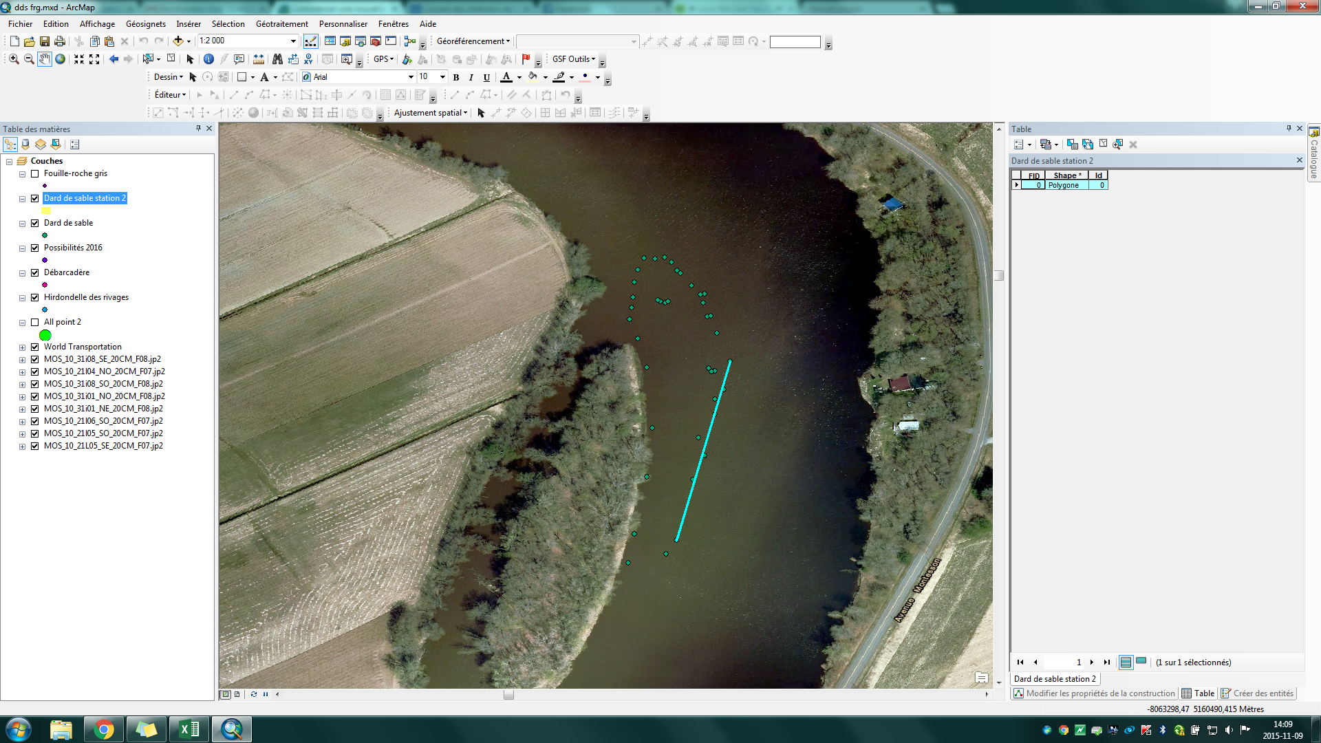

Hi,
I'm trying to create a polygon base on GPS data on my map but when I finish and click on save it is totaly different it's like arcgis save only 2 points.

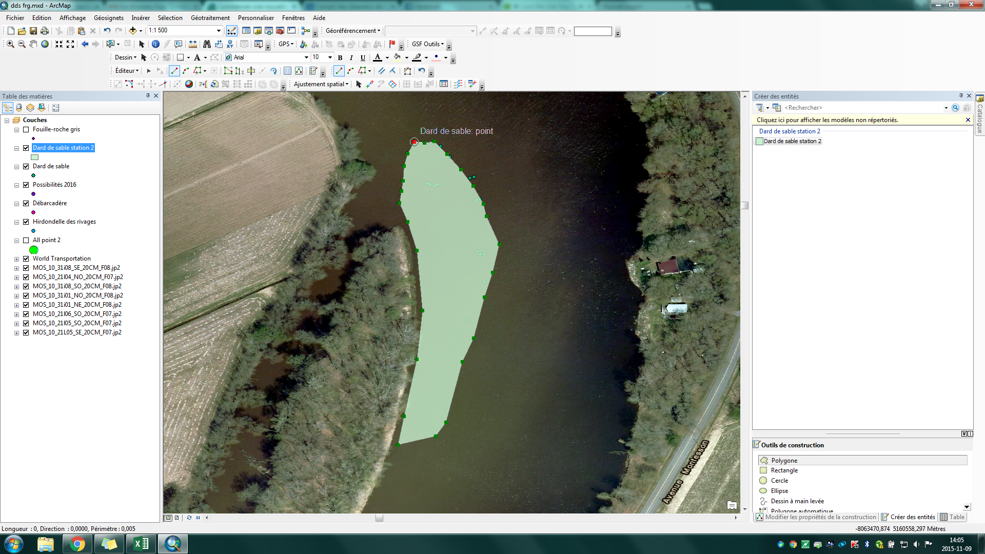

Are clicking on every point?
KarineRichard
Deactivated User
Yes it's me who create de polygon so I made every point

There's no data it's like my polygon doesn't exist
This is what I do for create it tell me if it's ok ;
1) Click right on catalog --> New --> Shapefile --> polygon --> ok
2) Start editing --> choose new_shapfile
3) create new entites
4) click on every point I want for make my polygon
5) double click on my new polygon
6) save editing
And after this my polygon desapear....
