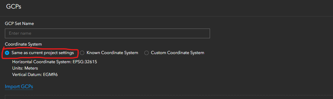

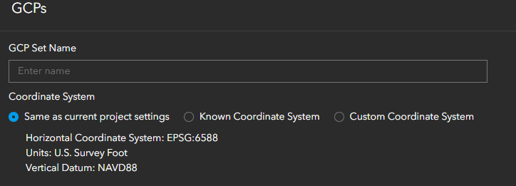

Hello, I am currently running into an issue with my orthomosic showing up in the wrong location when I export it out of site scan. In site scan it shows the correct location but when I share to my enterprise it no longer does. Previously I have exported things from site scan into my enterprise with no issues but this time, I added ground control points (they are in State Plane). I can see that in previous instances (where I had no issues) the coordinate system is WGS. But now, since my GCPs using state plane, i had to process the data in site scan using state plane but again, it is causing everything to show up wrong when exported.
Has anyone had this issue before? Could anyone help me with this?
FWI: this is from my previous missions without ground control that showed up in the correct spot:
and this is from my GCP mission that did not show up in the correct spot:

Hello, I learned it was my version of Pro that was not accepting the coordinate system. I upgraded to 3.3 and now it works fine. Thank you!
