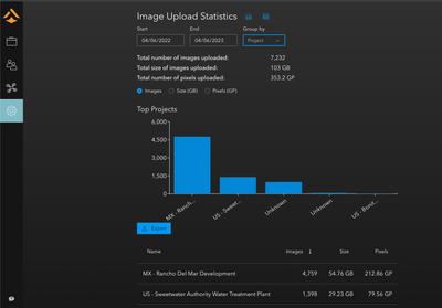

Hi @AngelaGray
Since you're an Admin, from the Org Settings page, you can export upload stats sorted by project which would effectively give you a list of every project that has had at least one image uploaded to it.
The Project Map view shows all the projects you're a member of. As an Admin you can see all project in your organization on the list view, but you need to be added as a member to view them on the map view. You can do this by selecting yourself on the Team page.
