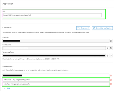

  3. Open the application item details and click Settings.
  4. Add https://aid-1.img.arcgis.com/apps/ssfa to the URL in the Application URL field.
  5. Under Redirect URLs, add the following URLs:
    http://aid-1.img.arcgis.com/apps/ssfa
    Save the new URLs to the portal app item. Note that prior versions of ArcGIS Enterprise will have a different appearance.Save the new URLs to the portal app item. Note that prior versions of ArcGIS Enterprise will have a different appearance.
