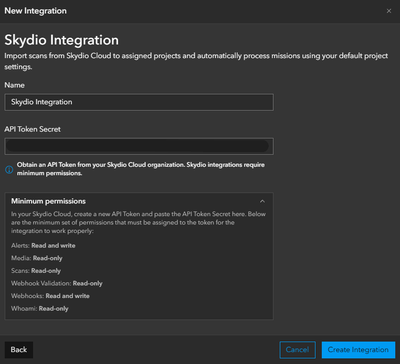

How to: Create the integration in Site Scan
You must be a Site Scan administrator to create and manage an integration.
  1. In Site Scan, browse to Organization Settings > Integrations.
    Organization Settings has a new Integrations menu.Organization Settings has a new Integrations menu.
  2. Click New Integration > Skydio Integration.
  3. Name your integration.
  4. Paste the Token Secret from Skydio.
  5. Click Create Integration.
    To create a new integration with Skydio, paste the Skydio API Token Secret with sufficient permissions.To create a new integration with Skydio, paste the Skydio API Token Secret with sufficient permissions.

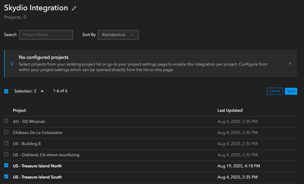

  6. Optionally, enable projects that you want to begin importing scans to. You can always come back to this later.
    A list of all projects in your organization. Enable those that you want to start importing scans to.A list of all projects in your organization. Enable those that you want to start importing scans to.
  7. Click Save.

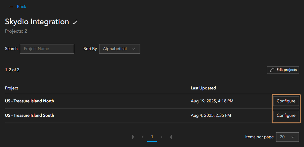

  8. If you enabled one or more projects, new Skydio scans will be automatically imported to the enabled projects that meet the import criteria. Further configure each project’s import criteria by clicking Configure. There are more instructions on configuring projects below.
    Shortcut to editing each project’s import configuration. You can also access this menu by opening the project from the project menu.Shortcut to editing each project’s import configuration. You can also access this menu by opening the project from the project menu.
Organization admins can always return to the Organization settings > Integrations page to enable or disable multiple projects at once.

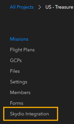

  1. Open a project that you want to configure the integration for.
  2. Click the Skydio Integration tab.
    Each project has a new Skydio Integration menu.Each project has a new Skydio Integration menu.

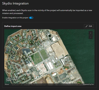

  3. If the project is not yet enabled, click the toggle to enable it.
    Once enabled, a map of the import area will appear.Once enabled, a map of the import area will appear.
    The current project location is used as the default import location. Any Skydio scan whose center point is within a radius around the import location will be imported to the project.

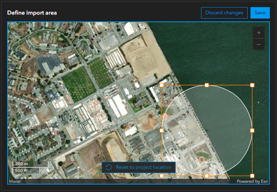

  4. To modify the import location and area, click Edit.
    1. Expand or reduce the area to the desired size.
    2. Drag the area on the map to change the import location.
    3. To move the area back to the project location, click Reset to project location. This will reset the import location to the current project location.
    4. When you are finished with your changes, click Save.
The area and location can be modified for each project.The area and location can be modified for each project.
