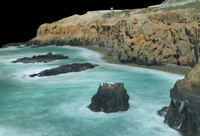

The output quality of the coastline is improved after using the waterbody correction.The output quality of the coastline is improved after using the waterbody correction.
The waterbody correction applies to all output layers including the 3D mesh. Textured features within the waterbody polygon, such as the rock outcrops, are reasonably preserved, while the rest of the water area is flat.The waterbody correction applies to all output layers including the 3D mesh. Textured features within the waterbody polygon, such as the rock outcrops, are reasonably preserved, while the rest of the water area is flat.

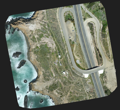

Another example showing the waterbody mask polygon traced from the processed True Ortho (no water correction).Another example showing the waterbody mask polygon traced from the processed True Ortho (no water correction).
The water area is complete and smooth after reprocessing with the waterbody mask.The water area is complete and smooth after reprocessing with the waterbody mask.
