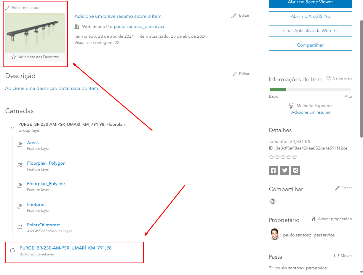

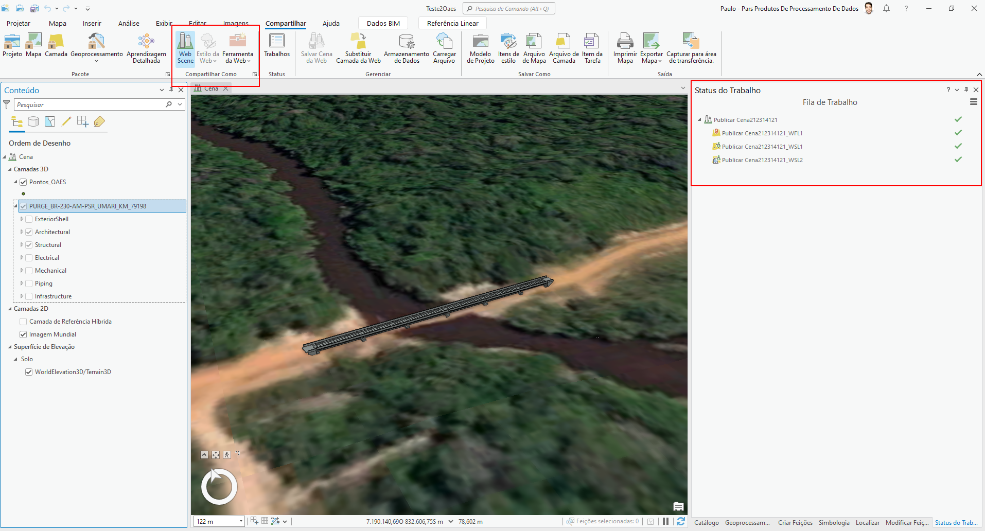

I'm trying to upload a Scene View with a Revit model to AGOL through the 'Web Scene' feature.

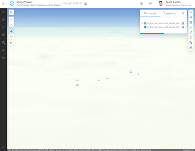

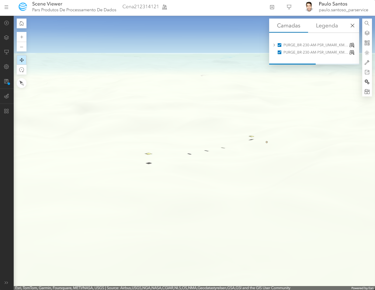

What happens is that whenever I upload a scene view, it doesn't appear properly on AGOL.
https://parservice.maps.arcgis.com/home/item.html?id=3e8cff3e98aa424aa8526a1e591f12ce
It shows that everything is fine based on the preview, but when I open the Scene Viewer or use this scene for another product, like creating a Web App, it doesn't appear. Look at the image below.

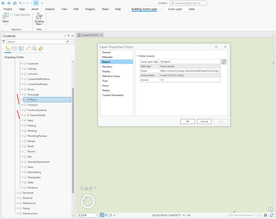

I tried to load the webscene and the BuildingScene layer that you shared back into Pro 3.3. Unfortunately, this didn't work out either. The sublayers present in the "full model" that should contain features (not being empty) are throwing errors in ArcGIS Pro as well and not being retrievable.

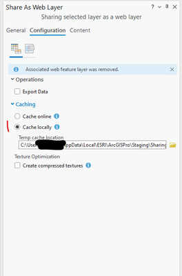

Did you try to publish the layer using the "cache on desktop" option?
