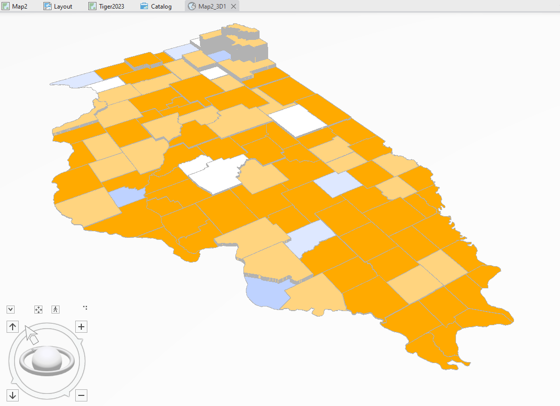

I'm trying to extrude based on an attribute (a subset of population) -- simply to visualize the magnitude of population. And also I'd like to apply symbology for graduated quantity classes of a percent attribute (in this case % served by a state programs).
This is simple to do in ArcGIS Pro (see screenshot), but the options don't seem to be available in AGOL, where only extrusion is available but not any second variable color symbolizing. Any tips?

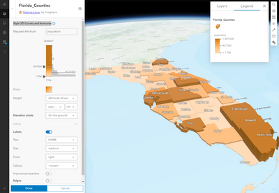

Did you try to apply the style `3D Counts and Amounts` to your data in Scene Viewer? With this style, you can extrude (either to a fixed height or based on attribute values) and apply a second variable for color symbolizing.

Thanks for replying - yes, that worked! I knew it was simple, but didn't understand that the "Choose the main attribute to visualize" step was independent of the choosing of the 3d Count and Amount extrusion field.
