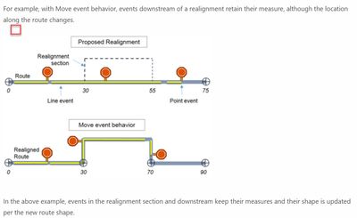

When testing Realignement, Event Behavior set on "Move", we found that upstream events remain unchanged as expected. However, events downstream retain the location along the route, measure values were adjusted. This does not match the description on the Esri page (see printscreen).
What could cause this difference?
We use ArcMap 10.8.1, for the Realignment "Recalibrate route downstream" is checked.
