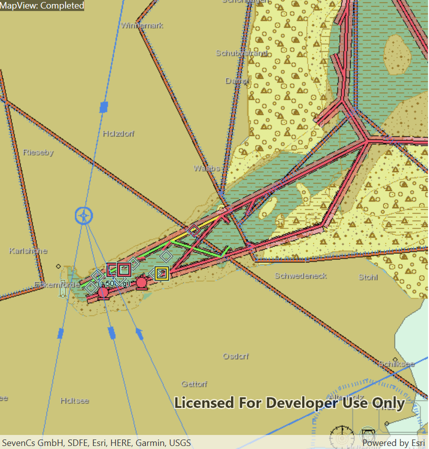

Hello!  Maps SDK lets you add certain parameters to add _all_ GetMap requests (such as an API key or a style configuration), but there is nothing built-in to customize each individual request.
I was able to WMS ChartServer's demo instance in the Maps SDK without problems, and it seems to handle GetMap requests the ordinary BBOX parameter well:
If using the BBOX parameter really doesn't work for your case, then the built-in WMSLayer probably would not work for you.  If you have the ENC exchange sets available, you might be able to use this data directly via EncLayer instead of going through a service.
