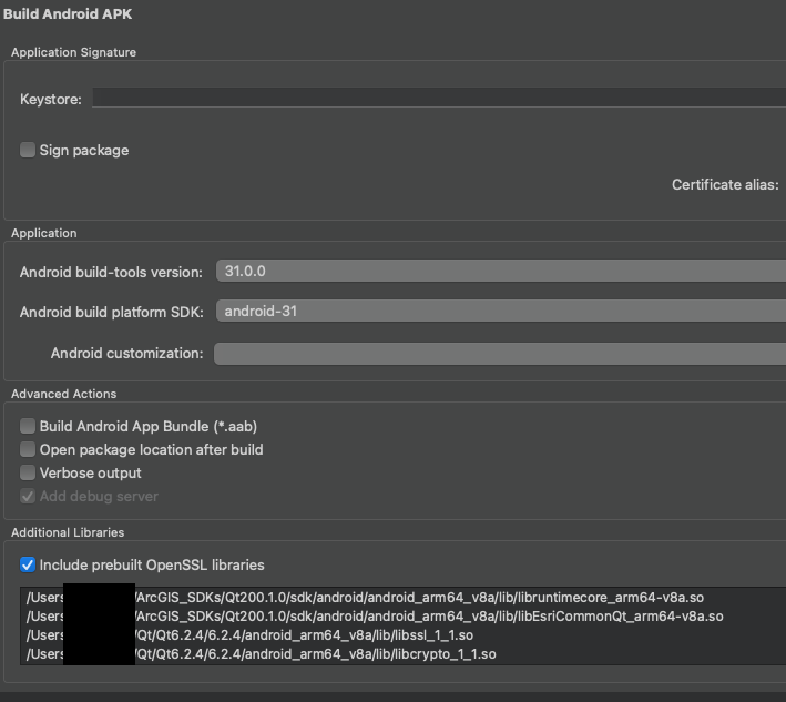

For the "The backend name 'cert-only' does not support TLS" issue, your app will likely require OpenSSL on Android.
In Qt Creator, in the Projects setting, under the "Build Android APK" section, there is a section called "Additional Libraries" where you can include the prebuilt SSL libs. See attached for what this looks like
Your paths and libraries may be different. This is just the general workflow to enable SSL in Android apps.
