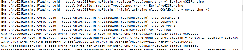

Application Console Output:
QSGThreadedRenderLoop: expose event received for window MainMenu_QMLTYPE_12(0x1706013a730 active exposed, visibility=QWindow::Windowed, flags=QFlags<Qt::WindowType>(Window), title=Ground Control Station - NG 0.0.1, geometry=482,728 1370x749) with invalid geometry: QRect(482,728 1370x749) on QScreen(0x1705ceda4e0, name=\\.\DISPLAY1)
