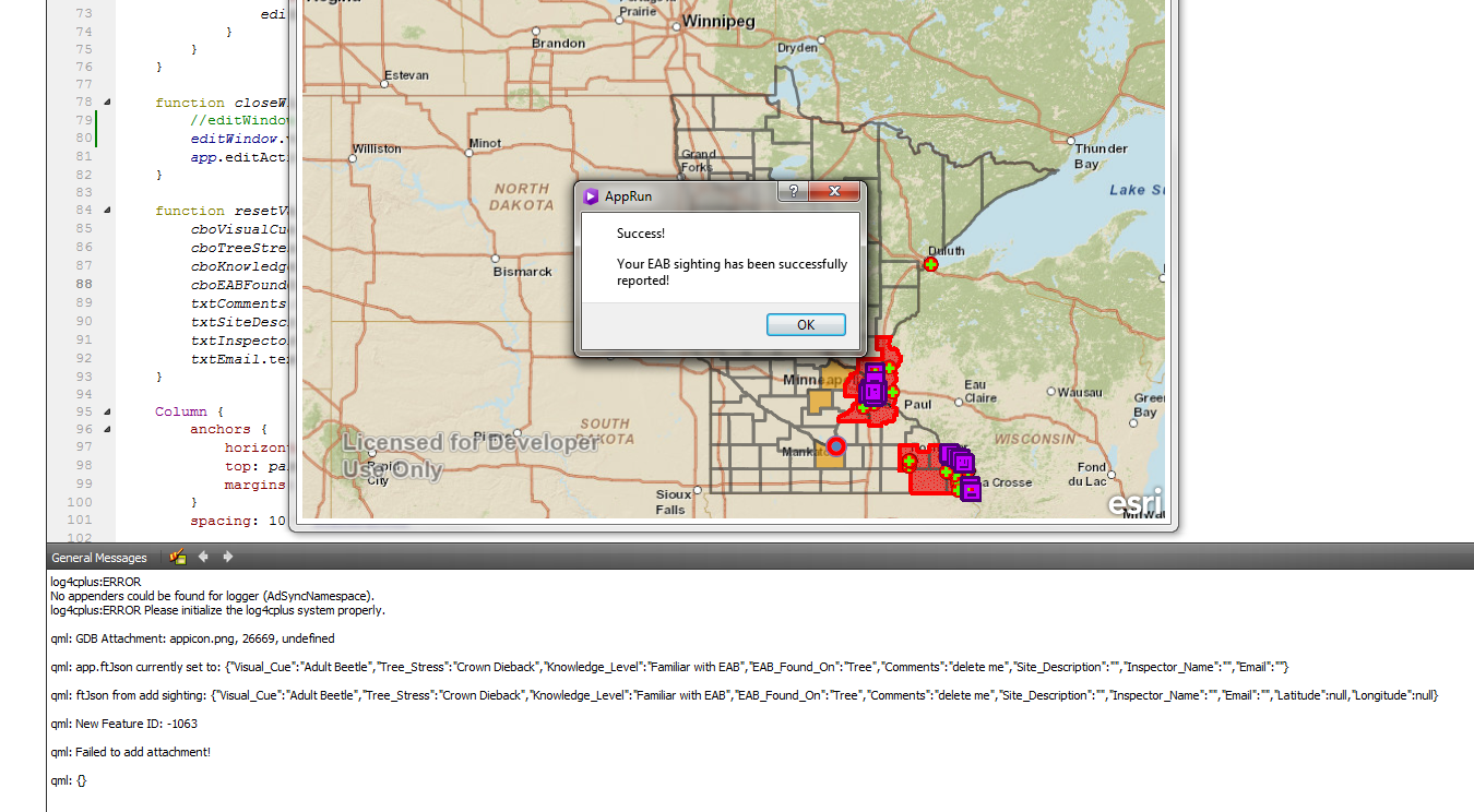

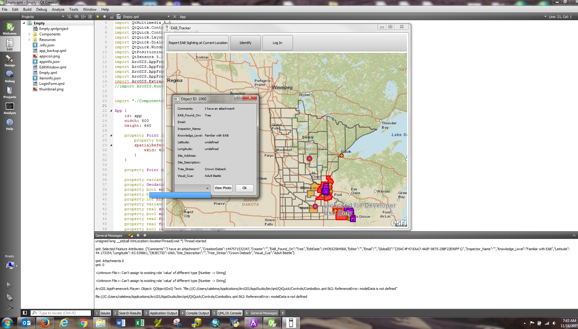

In the screenshot below I am doing an identify against a feature service point (OID 1060) that has one attachment.  The identify is working but I cannot seem to fill the combobox with the list of attachment images:
Another weird thing that happens here is the Latitude and Longitude (both double) values are showing up as undefined even when valid coordinates are added to the table and using the toString() method on them while building the list of fields throws an error.  However, I am more concerned about getting the attachments to show up.  The entire project code is attached.  But from the screenshot, you can see the console log is reporting that the selectedFeature is valid as it logs the resulting JSON, but for some reason the attachment count is coming back empty.

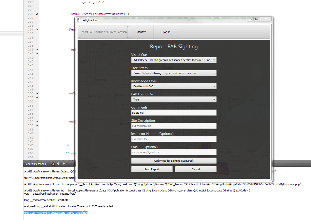

The second problem I am having is with adding attachments.  Below is my form.  It lets me select a file for attachment (currently only testing on Windows) and on the onAccepted() signal, the console logs the name, size and url of attachment (this comes back undefined which makes sense) by using:
console.log("GDB Attachment: " + geodatabaseAttachment.name + ", " + geodatabaseAttachment.size + ", " + geodatabaseAttachment.url);
And here I am getting an error that there is a problem adding the attachment.  On the onApplyAttachmentEditsStatusChanged() signal I am also not able to pull the errors as I get an empty JSON object.  I am probably doing some thing wrong there too:

For the first issue, is the combo box always filling it with the right number of attachments, only it doesn't display the name? You might need to set up a list view where the delegate accesses the "name" role from the model.
