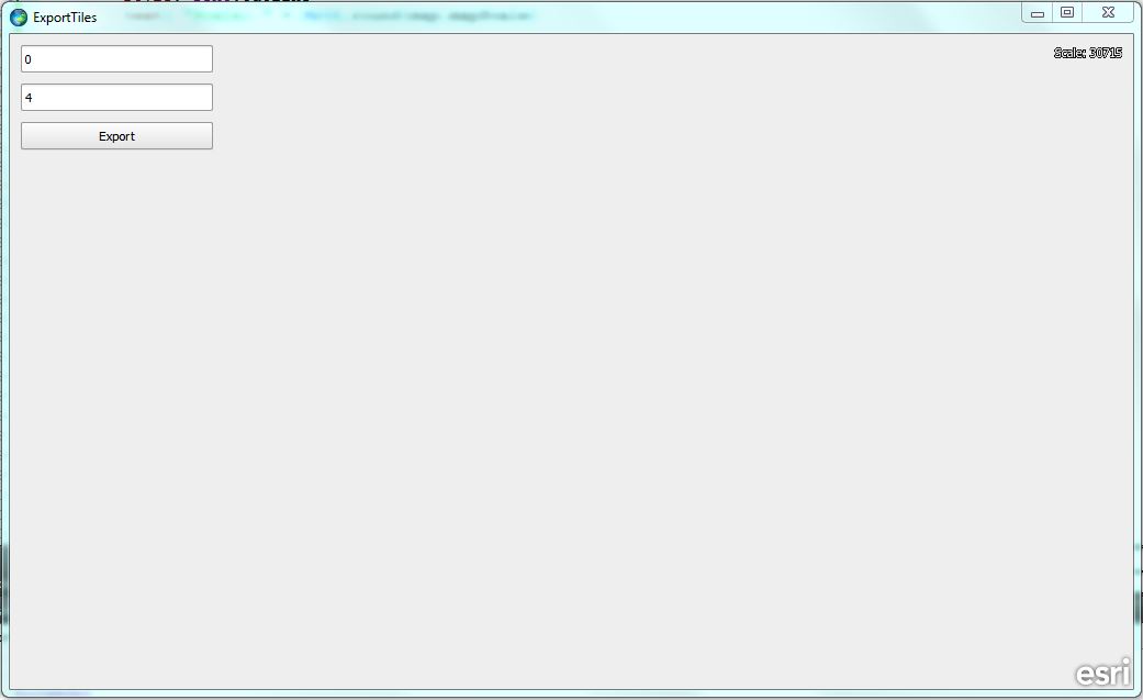

I m using RuntimeQtSamples/main.qml at master · ldanzinger/RuntimeQtSamples · GitHub  codes example to export tpk from service but when I click export button after give the Min LOD and Max LOD parameters exporting succeeded  export complated but I can not see tpk layer on the map and there is no any error. Here is my console output and after exporting tpk file picture :

After exporting tpk file :

Im  create new app and sign in with my credentials in developers.arcgis.com.I m set my client id and secret to ServiceInfoTask to use in app but when I click export button exporting succeeded  export complated but I can not see tpk layer on the map and there is no any error. Console output and result picture is like previous question.How can I solve this problem ?

It works for me when I zoom to the US, and put 0-8 as my LOD. The sample is pretty bare bones, and doesn't do any validation to make sure the LODs make sense based on the extent/scale you are at. Try zooming to the US lower 48, and do 0-8, and see if that works.
