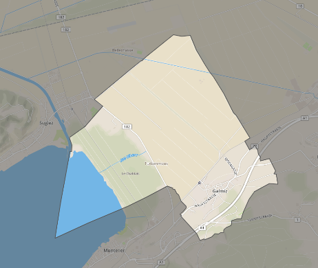

Hi i want fade my map outside its geometry like i have done javascript api like in the link.
Query : How to create the gray area over the extent expand to 10 so that i will perform difference between geometry and the extent
Geometry difference(Geometry geometry1, Geometry geometry2)
I want to do it same in qt sdkFade back map outside of polygon

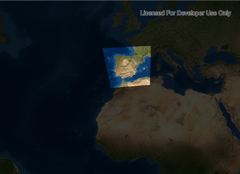

You can accomplish this by adding a Polygon graphic that has a hole in it.
Here is an example where I have a multipart polygon - one part has 4 points and the other has 4 as well. The interior part goes in counter clockwise order and is shown as a hole. This is described in the REST specs a bit for ArcGIS as a whole - Geometry objects—Common Data Types | ArcGIS for Developers
MapView {
    anchors.fill: parent
    Map {
        BasemapImagery{}
    GraphicsOverlay {
        Graphic {
            symbol: SimpleFillSymbol {
                color: Qt.rgba(0,0,0,.75);
            geometry: Polygon {
                json:  {"rings":[[[-18684976.52965096,13174661.735383898],[11421379.755389877,11822129.922245625],[13775786.985667616,-9517816.462824922],[-18384413.904509123,-8215378.42054362],[-18684976.52965096,13174661.735383898]],[[-1202250.5005673468,3907314.1268438715],[601125.2502836883,4057595.4394147918],[651219.0211406611,5860971.190265823],[-1603000.667423129,5760783.648551878],[-1202250.5005673468,3907314.1268438715]]],"spatialReference":{"latestWkid":3857,"wkid":102100}}
To keep this code concise, I just defined it in JSON, but you could use the PolygonBuilder class and add several parts to it. Each part should contain points. The order defined will be important for making it topologically sound and display as you desire
rsharma
I am trying it this way and is succeed also and
want to expand graphics of overlayGray to some more km distance from my extent, can u help me how to expand it:my extent
Here in  getExtentEnvelope() i counted the xmin xmax etc values manually, so the polygon appears on my whole screen. The pictures i attached below are some zoomed out images.

rsharma
Hi I am trying to accomplish like this picture first make difference of 2 geometries then expand the extent of gray color to few kms
I have made geometry difference but does not know how to expand the gray color extent
