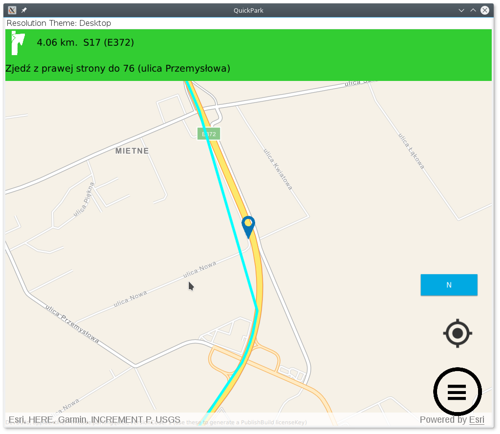

I'm working on a navigation app. I have noticed that sometimes there is a divergence between the map and Route plan. Clearly, you can see this in attached pictures, can someone shed some light why this is happening?
My QML code:

Looks like the basemap tiles (which I assume are pre-rendered imagery service) has road lines that are different from the network lines in the network dataset. In essence, you are overlaying two different datasets and noticing the differences.
Just because both datasets seem to be hosted by ESRI doesn't guarantee parity.

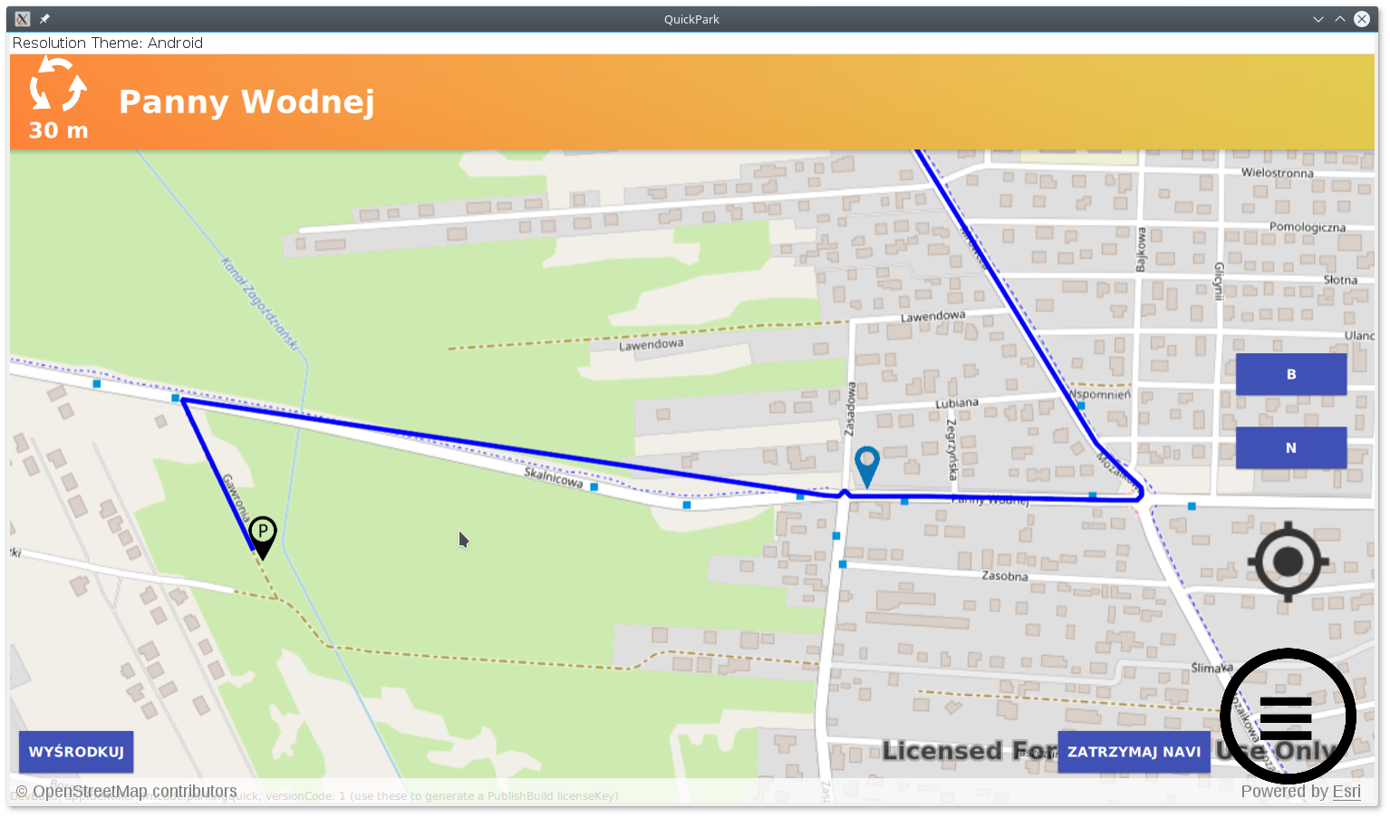

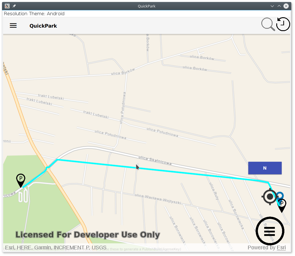

Kind of hard for me to accept that answer. No matter what map I use provided by ESRI, like BasemapNavigationVector, there is always the same divergence problem, and I know the roads are mapped correctly, I have checked this driving with gps. What is more ESRI has a support for Polish language, thats why I choose it, it has driving directions in Polish language, so it is unlikely that is has network dataset so wrong.

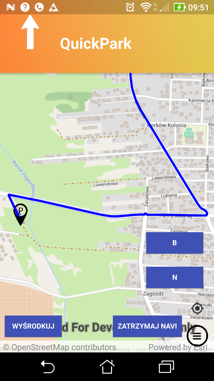

Ha, and a minute ago I have discovered that when i install my app on Android phone and I select very the same route, route line is drawn correctly.
So what the heck is going on?
