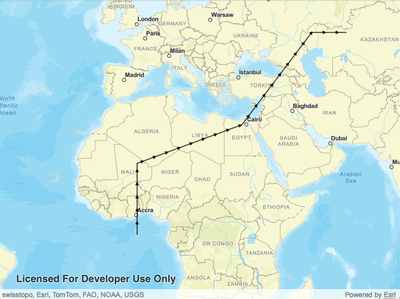

Hi folks,
I have a GPS track and I would like to have directional arrows displayed along it. I see this has been done in the JS library:
Arrows along a line | Sample Code | ArcGIS Maps SDK for JavaScript 4.30 | Esri Developer
I have tried creating point symbols and orienting them, but it is messy because they would need to be moved at different zoom levels and are an expensive solution.
Is there a recommended way to do this?
Thanks!

Hi Justin,
This can be achieved with Multilayer (CIM) symbols. You could take a few different avenues to get the end result. The simplest port of the JS samples is to take the Symbol JSON they used and use it in Maps SDK.
Here's an example I tested with:

JustinSteventon
Thanks for the fast response, Lucas. I plugged this in, but the Symbol::fromJson(symbol) returns null. I verified that the JSON was well formed. I am using 100.15. I will try with the MultilayerSymbol API and report back.
JustinSteventon
Reporting back. The line in the JSON that caused the failure was "angleToLine" - perhaps that was not supported in 100.15. In any case, that seems to be the default, so removing it was fine.
I had good luck creating the classes manually, but there seems to be no way to modify the marker placement. Did I miss something?
auto geometricEffects = QList<GeometricEffect *> { new DashGeometricEffect(QList<double>{0.1, 10}, this) };
auto solidStrokeSymbolLayer = new SolidStrokeSymbolLayer(lineWidth, QColor(0, 0, 255, 200), geometricEffects, this);
auto simpleFillSymbol = new SimpleFillSymbol(SimpleFillSymbolStyle::Solid, QColor(0, 0, 255, 200), this);
auto arrowJson = R"({"rings": [[[-8, -5.47],[-8, 5.6], [1.96, -0.03], [-8, -5.47]]]})";
auto symbolElementPolygon = new VectorMarkerSymbolElement(Geometry::fromJson(arrowJson), simpleFillSymbol->toMultilayerSymbol(this), this);
auto vectorMarkerSymbolLayer = new VectorMarkerSymbolLayer(QList<VectorMarkerSymbolElement*> {symbolElementPolygon}, this);
auto symbolLayers = QList<SymbolLayer*>{ solidStrokeSymbolLayer, vectorMarkerSymbolLayer };
auto multilayerSymbol = new MultilayerPolylineSymbol(symbolLayers, this);
graphic->setSymbol(multilayerSymbol);
In any case, creating the structures from JSON is straightforward and easy to work with, so I am going to stick with that approach.
Thanks!
