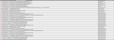

VerticalAlignment and Horizontal Alignment are functions of TextSymbolArmandoGarcia3_0-1721833401994.png

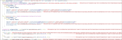

Here a snippet of code that worked with 100.13, but not needs updated with 200.3
I believe we will figure it out, but wanted to reach out to people like you. Thank you for providing the notes you did, they may be of use if we encounter any issues related.
JamesBallard1
Hi @ArmandoGarcia3 .
@TroyFoster is spot on with point 2, and the "incomplete type" errors you're seeing are related to our product following c++ best practices and forward declaring everything possible. You can either include all those headers in your project, or we provided an "ArcGISIncludeCompatibility.h" header for situations like this which brings in everything. We don't recommend using that header as it will negatively impact your compile times, but it should get you beyond those errors quickly.
GuillaumeBelz
Documentation for TextSymbol is here https://developers.arcgis.com/qt/cpp/api-reference/esri-arcgisruntime-textsymbol.html#TextSymbol-1.
Most of the time, when you have an error about "invalid use of incomplete type 'Esri::ArcGISRuntime::Xxx'", you can fix that by adding the corresponding header #include "Xxx.h".
For enumerations, there is usually a XxxTypes.h header to include. For example, for HorizontalAlignment enum, the header is #include "SymbolTypes.h".  https://developers.arcgis.com/qt/cpp/api-reference/symboltypes-h.html#HorizontalAlignment-enum
You can find the header to include using the search box in API reference https://developers.arcgis.com/qt/cpp/api-reference/, the header is specified in the top of the page for each class and enumeration.
ArmandoGarcia3
Thank you all.
I used "ArcGISIncludeCompatibility.h" and it fixed all my ESRI issues.
I had to make some edits in the .pro file to find certain items
I will look into including the individual headers so I don't have to use the Compatibility header file, but my application still compiled rather quickly.
After making some adjustments in the .pro file, it fixed some final errors, and the GUI is up and RUNNING.
