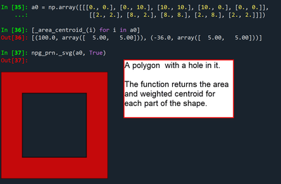

area_centroid_example.pngIt is easy to get arcpy shapes, geojson geometry and various relatives to arrays.
You can add this to your geometry arsenal.
It can be used for convex/concave/multipart (including parts with holes).
Clockwise (cw) geometry returns a positive area, holes (ccw) a negative one.
The centroids for both parts can be weighted or proportioned if needed (let me know, if so and I can provide another example).
