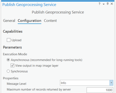

Here are the publishing options
 I've tried various combinations and nothing works. I do see various errors in the server manager log:
