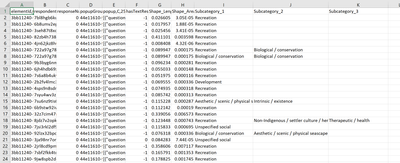

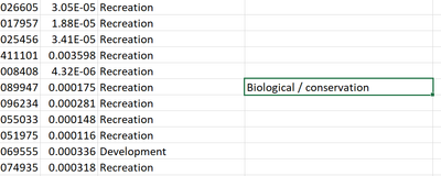

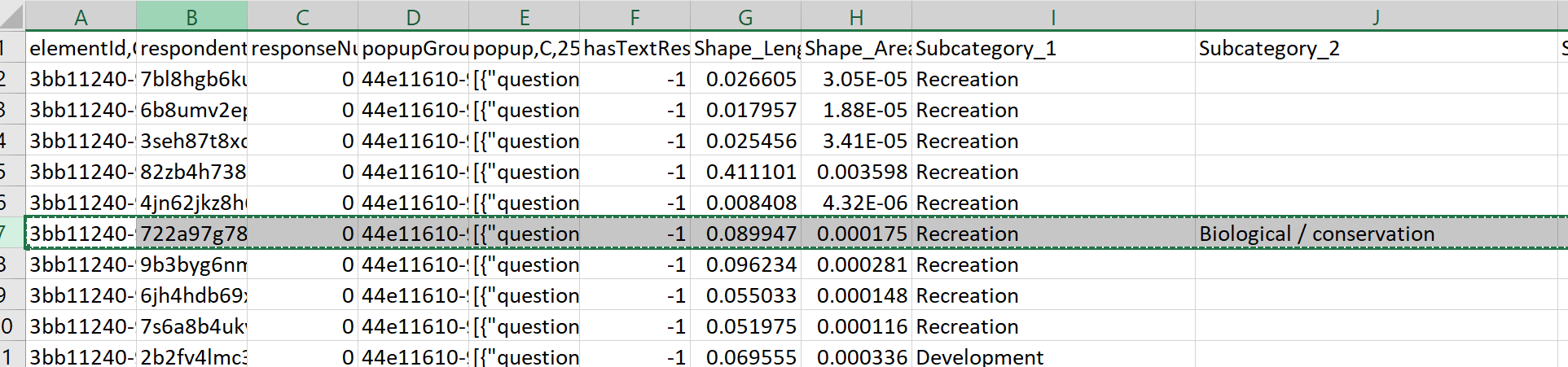

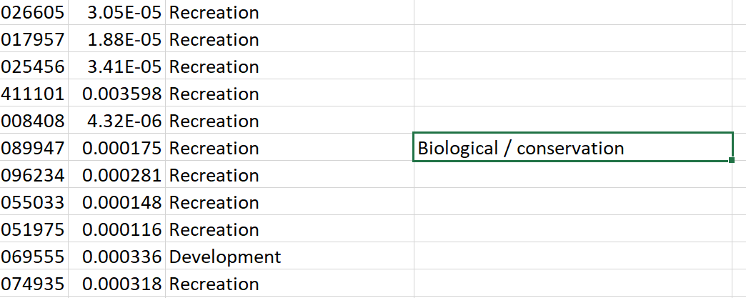

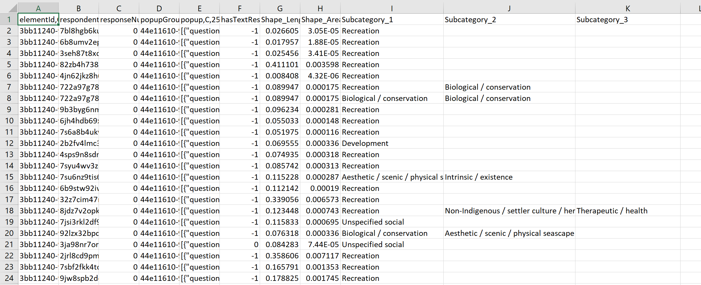

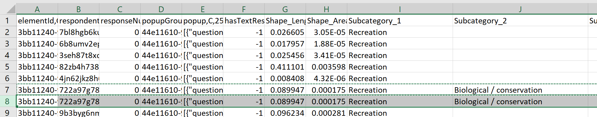

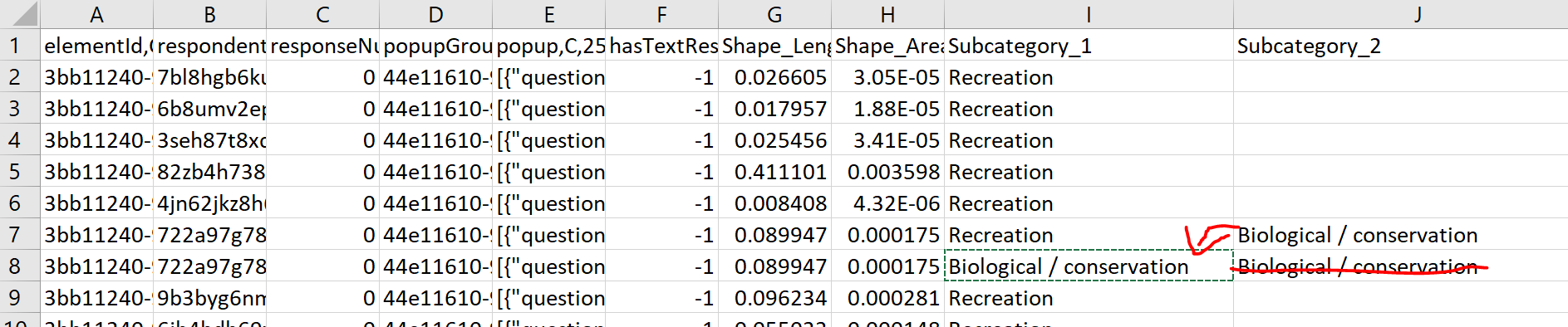

EDIT I have attached screenshots of what this workflow looks like in Excel
  1. Initial Table
  2. Find value that is not empty in Subcategory_2
  3. Copy that row
  4. Insert into row below
  5. Have the value in Subcat_2 replace the duplicated value in Subcat_1
Since I am inserting a row from the same feature class, the length, schema, geometry is all the same.

Basic code would be something like this:
# read all attributes you want to copy, not just Subcat_3! Especially Shape, else you won't see the feature.
fields = ["SHAPE@", "Subcat_2", "Subcat_3"]
# use an SQL query ("Subcat_3 IS NOT NULL" or "Subcat_3 <> 'Nothing'")
values = [list(row) for row in arcpy.da.SearchCursor(social_layer, fields, "Subcat_3 IS NOT NULL")]
# I don't understand why you would want to have unique values?
# According to your question, you want to copy _every_ row with values in Subcat_3.
with arcpy.da.InsertCursor(social_layer, fields) as cursor:
    for row in values:
        # replace Subcat_2 with Subcat_3, delete Subcat_3
        row[-2] = row[-1]
        row[-1] = None
        # insert
        cursor.insertRow(row)
