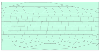

For perfect square/rectangle polgon Shapefiles, I was able to get the vertices from Extent ( except for multiparts) but have to traverse the vertices for irregular polygons as shown below. ss2424_0-1634651883151.png

Seeing you are working with multiple polygons in multiple shapefiles, it is best to start isolating the issue by isolating the data.  What happens if you take a single polygon from a single shapefile and run it many times, do you see different results?
ss2424
I exported a single polygon from each of 2 different Shapefiles and I saw consistent  results. The firstPoint returned for a polygon in Shapefile 1 is SE corner while the other polygon from Shapefile 2 returned SW corner first.
JoshuaBixby
MVP Esteemed Contributor
Is that what you are perceiving to be the inconsistency, the fact that one polygon starts in the SE corner while the other starts in the SW corner?  The order of the vertices is determined when a shape is created, not when a shape is read, so the source shapefiles are not following a consistent rule with building polygons.
ss2424
Thanks for confirming..I modified the code to get the  extent of the polygon and then get the 4 corners from extent...though I'm seeing expected results I want to make sure I can go this way than getting the vertices using my code above(originally posted) or is there an advantage of one method over another?
