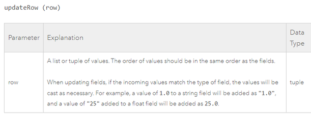

From all the documentation, it seems as if the cursor.updateRow() method takes a list or tuple as its parameter.
What am I missing here?  The row is a list object and is taken into a method that only accepts lists and tuples, so why am I getting this type error?

A list (or tuple) of field names. For a single field, you can use a string instead of a list of strings.
Since you are using a single field in the updatecursor, did you try a string instead of a list
newPNUM = prefix + apnVal

I was completely misinterpreting the error.  I thought row was the parameter causing issues and didn't even notice that newPNUM was a list.
Thanks! That solved the problem for me.
