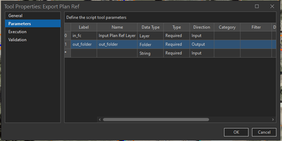

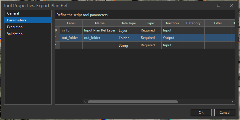

Hi everyone,
I created a script that runs successfully in the ArcGIS Pro python window, but I would like to re-create this as a script tool to eventually be used for a geoprocessing service.  I am having problems setting the output folder in the script tool.  What is the correct data type to use when setting up the tool parameters?  I've tried "Folder", "Workspace", and "String" with no success. (See below)
Basically the script copies files from a file directory based off a user selection and a hyperlink to the file using the "LINK" field.  Any suggestions would be greatly appreciated!

ChrisRingo
Probably either Folder or Workspace (or even String) would work for the parameter type for "out_folder", but you'll want to change the direction to "Input". Even though you'll be writing files to that folder, it's still an input parameter.
Also, just in the interest of more elegant coding, you should move the statement "dest_path = arcpy.GetParameterAsText(1)" up to the top and out of the loop - it only needs to be executed once.

shildebrand
Thank you!  Switching the folder to an input parameter did the trick!
