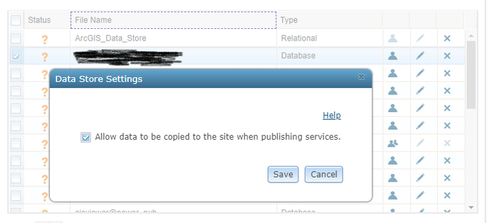

Here is a screenshot from my Server Administrator.  You can see a column on the right that allows the conversion of database connections to items (one person icon) or the sharing of those items to groups (two people icon).  You can also see how the connection I've selected and clicked Settings for allows (or disallows) the copying of data to the server.
