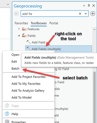

are you accessing batch processing like this is or the tool not working?

That is how I am accessing the the batch process but it is for a custom python tool box.
