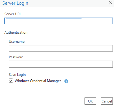

I assume this is a relatively simple question with a relatively simple answer. When opening this ArcPro project file, I am presented with a request to enter credentials:
Even though I select Windows Credential Manager, it does not save, but that's fine for this purpose.

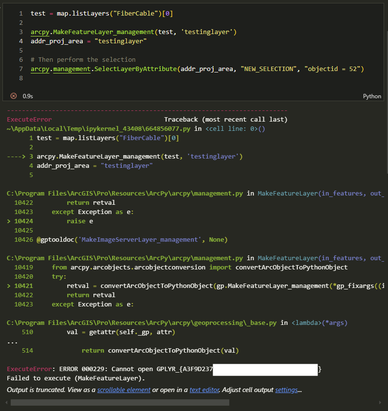

When accessing this through Arcpy or attempting to at least, I get this:
I assume this is due to the authentication, we do not have access to the REST environment, so I cannot use the API for Python, so Arcpy must be employed.

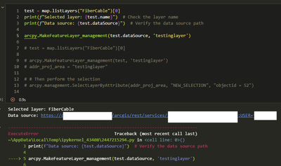

I would check to make sure the layer is correct.
test = map.listLayers("FiberCable")[0]
print(f"Selected layer: {test.name}")  # Check the layer name
print(f"Data source: {test.dataSource}")  # Verify the data source path
arcpy.MakeFeatureLayer_management(test.dataSource, 'testinglayer')

TonyAlmeida
MVP Regular Contributor
 Try using the layer object returned by the MakeFeatureLayer result, line 8.
# Verify the original layer details
print(f"Original layer: {test.name}")
# Returned layer object
result = arcpy.MakeFeatureLayer_management(test.dataSource, 'testinglayer')
# Get the layer object from the result
testing_layer = result.getOutput(0)
# Now work with `testing_layer`
print(f"Selected layer: {testing_layer.name}")  # Layer name
print(f"Data source: {testing_layer.dataSource}")  # Data source path

Thank you for another suggestion, unfortunately this didn't work either. This time it's related to a bug regarding the MakeFeatureLayer using the Feature Service link. I was told by ESRI support that this was too advanced of an issue to work through so it was marked as a Known Limit which means it will not be worked on.
This is the error I received:
Bug link: https://my.esri.com/#/support/bugs/bugs?bugNumber=BUG-000144037
