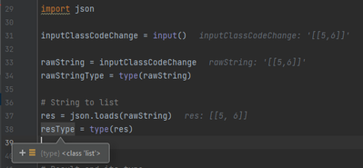

If you want to keep the [[1,2]] format, you can parse it out with json.
import json
inputClassCodeChange = input()
rawString = inputClassCodeChange
rawStringType = type(rawString)
# String to list
res = json.loads(rawString)
resType = type(res)
import json
# String to list
resType = type(res)

I have gotten this to work (or at least not fail)!
One more library of tools I need to learn...
