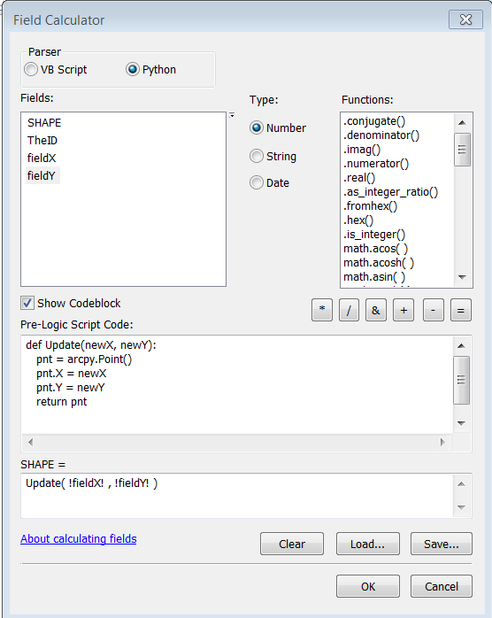

I'm trying to update the SHAPE field of some points by using field calculator to update the SHAPE field based on X, Y fields in the attribute table. Can this be done? I'm trying the below calculation, and the points are changing location, but not to a location that is near either the X, Y fields I'm asking it to. I'm not sure where I'm going wrong here.

The actual reason why the calculation wasn't working is since you return a Point object when the geometry is in fact a PointGeometry.object.  See the field calculator expression below:
So you create a point object with the new X and Y and then use the point object to create the point geometry.. What you did in your second example is providing the point geometry to the function and modify the point X and Y properties using the first part, and returning the point geometry object again

Shoot, I had the script wrong. I needed the Shape as a parameter. This works. Thanks Dan.

Rethinking it I realize that you don't have to specify the spatial reference, since the featureclass already has this defined. You could use this to make thing more simple:

The function parameters in the code block should not have exclamation marks, that's only for the field names in the expression. Get rid of all ! characters in the code block.
