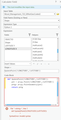

I'm using ArcPro, and the Python might be different. Can you tell me why my code isn't working, please?
BlakeTerhune
MVP Alum
The function parameters in the code block should not have exclamation marks, that's only for the field names in the expression. Get rid of all ! characters in the code block.
